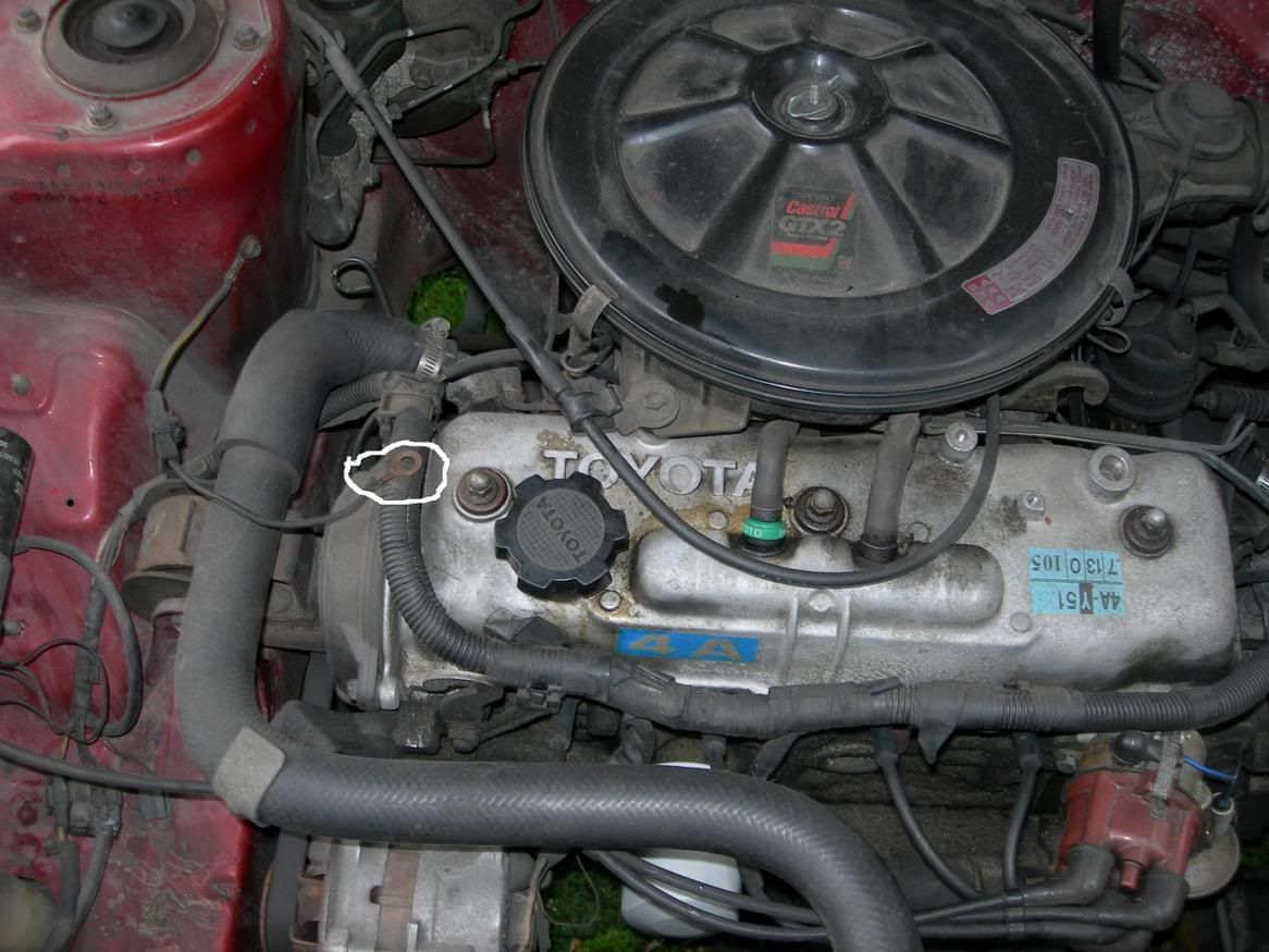

Postby Volatile » Tue Dec 13, 2005 8:41 am
where does this wire go?

Postby Santa'sBoostinSleigh » Tue Dec 13, 2005 8:50 am
onto the bolt next to it on the motor?

Postby CozmoNz » Tue Dec 13, 2005 8:52 am
about 10mm to the right, under that bolt.
its an earth
you may find the car runs a bit odd without it, so connect it up :). (hondas especially run strangly without their rocker cover -> chassie ground connected).

Postby Volatile » Tue Dec 13, 2005 9:13 am
Really? i just bought the car and found it floating in the engine bay
So is this right?

Postby Santa'sBoostinSleigh » Tue Dec 13, 2005 9:20 am
yup thats correct-o-mondo :)
there should be a few engine earths around the place

Postby Volatile » Tue Dec 13, 2005 10:16 am
well i put it on, no change!
Any ideas, got missing/hesitation problems between 2500rpm and 4000rpm ish
