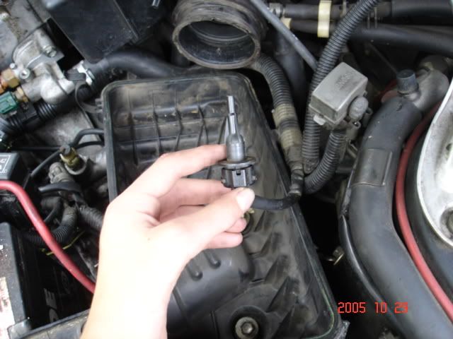

Hey all, i have toyota corolla fxgt.. 1990.
Now, it has a pod filter in it, but the thing is.. the sensors are just hanging in the bottom half of the airbox.. there are two sensors which i presume are Air conditioning, and air tempature.. Where can i put them?
Im aware that they use to go in a airbox (obviously the top half as the bottom half is still there holding the podfilter up as i think the flexi pipe would bend from weight )
But, with the podfilter in it, i have no idea where to put these censors.. Help? where shall i mount them..

Postby Ae92typeX » Thu Dec 29, 2005 12:25 am
best thing to do is to put them into the intake line somewhere as they were origonally. Ive seen several done with holes drilled into the intake pipe & the sensors put in there.
Lots of people have also run theirs with them just hanging and 'reported' no problems...

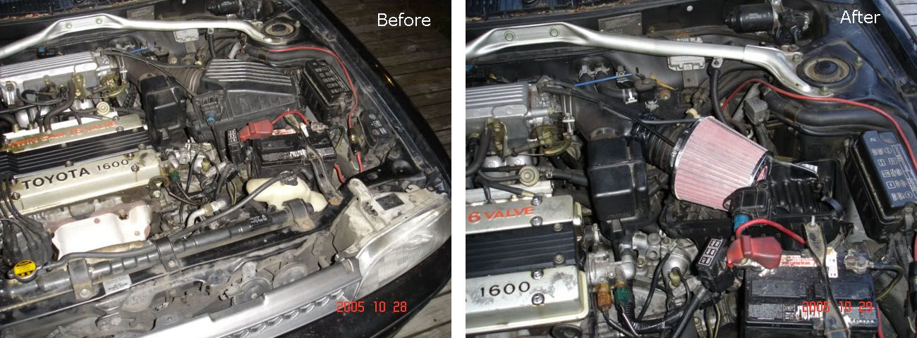

Postby Zyros » Thu Dec 29, 2005 12:26 am
Haha, will it still pass the w.o.f like this, post some pictures up of yours ;)
Yup, heres some pictures.. I have a before and after one already uploaded ill throw on.
Not very helpful, but heres some pictures of the sensors plus the straw like tube which was also enclosed in the top half of the airbox..
Yup.. Where to put them now lol

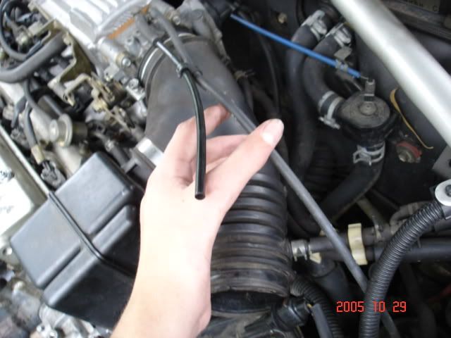

Postby CozmoNz » Thu Dec 29, 2005 12:56 am
First is a vac hose, second is the air temp sensor.
vac hose just either plug it (small screw), or get a T peice and t it into that other vac hose just near it.
the air temp, you can either leave it NEAR the poddie, or drill a hole in the piping, and push it inside there. (with something to hold it in place / glue etc)
and it scares me, that your hands look feminine....

Postby CozmoNz » Thu Dec 29, 2005 1:08 am
wait, that vac hose looks like its running to that blue thing? what is that?

Postby CozmoNz » Thu Dec 29, 2005 1:38 am
well, you have a vac leak... so plug it with a screw (wind a screw into it) so it dosnt leak anymore :D (plug it with your thumb and see if it idles / runs better).
Duno what the blue sucker does.

Postby Malcolm » Thu Dec 29, 2005 2:20 am
clearly it is your ISC (idle speed control valve)
might pay to put a filter of some sort over the inlet of it, or plumb it into the intake pipe.

Postby Caveman » Thu Dec 29, 2005 9:33 am
This is the line which goes to the VSV. If not using VSV block it.
The is the air temp sensor. Put it between your trottle body and filter with the pointy end going in the pipe.
This is a VSV, or V-ISC as All_Fours stated. You should attach the end which was originally in the intake back in, the other pipe should attach back to the one in photo 1.
Your an idiot for putting your pod there and you deserve all the powerloss you get. In the future it might be a good idea to box it and duct cold air to it, or move the pod to a colder location.

Postby jondee86 » Fri Dec 30, 2005 5:45 pm
The valve with the blue plug is your idle-up (V-ISC) valve. It is supposed
to be on the end of the shiney black tube, and it adjusts the idle speed
according to the load that certain ancilliary items place on the engine.
It will not work when it is removed from the airbox. What you have now
(with the end of the tube open) is a constant leakage of unfiltered air into
the intake plenum. This will increase your idle speed all the time.
The other hose probably leads to the charcoal canister, and extracts
petrol fumes from the fuel tank vent system.
The temperature probe should be in the intake ducting.
Cheers.... jondee86

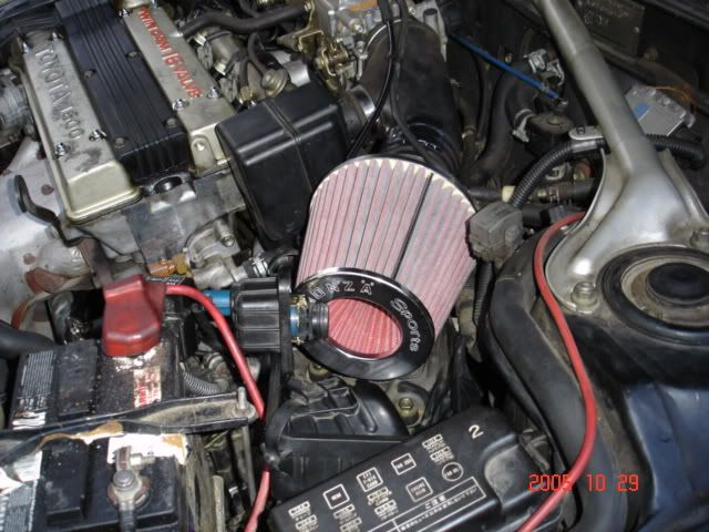

Postby Cakky » Fri Dec 30, 2005 6:37 pm
couple of pics, cold air box coming soon...
will the afm be alright poked into the neck of the filter like that? does it need to be pushed all the way? its currently pushed in about half way..
and the vsv?? mounted to the sway bar..

Postby Caveman » Fri Dec 30, 2005 6:44 pm
I think you maybe confusing the afm with something else.
Do a little research first.
