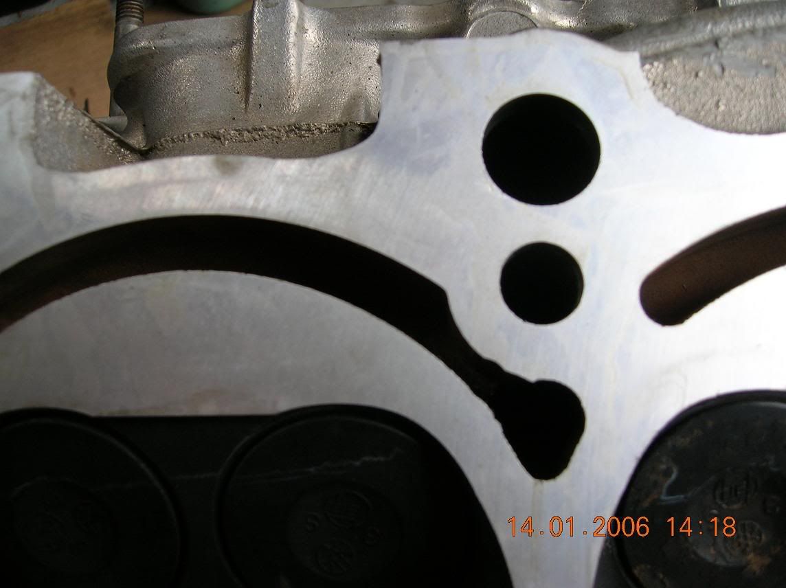

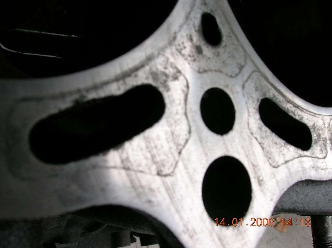

Anyway, I took some pictures (sorry, they're big for clarity). I got the head back but wonder whether it's a good enough finish. I can feel the grooves if I run my fingers over it, but only just.
Head:
Now the block, which actually feels smoother than the head (having sanded it with 800 wet sandpaper)
What is probably of more concern to me than the pitting is the swirl marks presumably from when it's machined from the factory.

I do at least one head job a month Ive always fitted "Regular" headgaskets dry and never had any come backs. I use brakleen or kero and a fine oil stone to prep decks, You can tell with the headgasket sitting on the dowels wheather there is going to be a sealing problem.
Copperspray prevents the gasket shifting under torque and is supposed to conduct heat better.......well "In theory" but thats all.
Worked with a guy that used the VHT stuff on all h/g jobs and he had no comebacks as long as proper procedures were followed.
I cant see any probs with those pics, but then again Ive never used metal headgaskets only regular ones. The deck would have to be mint if the gasket hasnt got any beading to seal......... Yep Mill the deck :lol:

Measure the block and see if it has any warp in it. I had a copper gasket made up for me, skimed the head, no pitting on the block used the VHT copper stuff and put it together. Had no compression in two cylinders, went straight into the water jackets.
The only reason was that the block was a little warped. The head and Block must be straight and true when using metal gaskets. In my case a normal gasket fixed the problem.
If i were you i would measue the block and then decide what to do.
