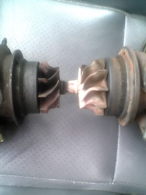

ok ive got a turbo from a gtt caldina that i was going to use on a mates st185 celica. now i originally thought it would be the same as a st205 and be a ct20b. However i recently got told that it might be a ct26. so with that in mind i removed the main part of the ct26 from the st185, just leaving the exhaust housing on the car. Upon comparison however the exhaust sides of both turbos are very different. The ct26 exhaust turbine is about 4 and 8mm bigger on the inducer and exducer, respectively. Also the gtt turbo appears to have a steel exhaust wheel,which i thought only the wrc st205's had. Anyway im a bit confuzzled as to what to do next. Whether to get a st205's exhaust housing and see if will mate up, or something else. any light on this situation would be most helpful.

Postby Skin » Tue Jan 31, 2006 9:52 pm
heres a pic of the turbos side by side, caldina one on the left
and a st205 ct20b has that dowel as well...

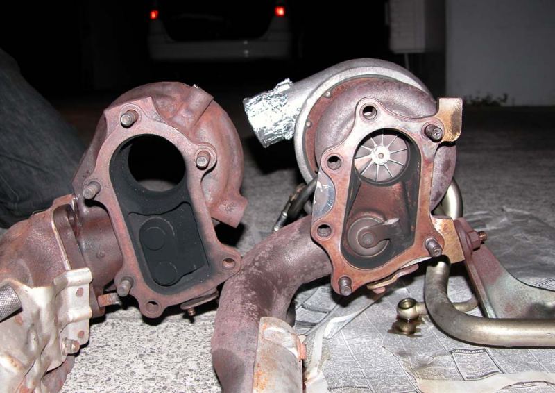

Postby Dell'Orto » Tue Jan 31, 2006 10:31 pm
fivebob wrote:If you're going to use a made up name get it right :lol:
Doh, close enough for me anyway :P
Only a 5 bolt exhaust flange too?
Postby Skin » Tue Jan 31, 2006 10:34 pm
no that pic must be of the supra housing, as the caldina one is 6 stud and you can see in that pic its just the housing, not the stupid housing/manifold one piece abomination... :P

Postby fivebob » Tue Jan 31, 2006 10:58 pm
Skin wrote:no that pic must be of the supra housing, as the caldina one is 6 stud and you can see in that pic its just the housing, not the stupid housing/manifold one piece abomination... :P
Oops, it's not even that, it maybe the exhaust of the other turbo known as the CT15b, from the late model 1JZ if IIRC. Can't find where I got that pic from although it originally came from EBay judging by the watermark.
Postby fivebob » Tue Jan 31, 2006 11:01 pm
CT26(MR2/ST185 Variant) on the left , CT15b (Caldina variant) on the right.
