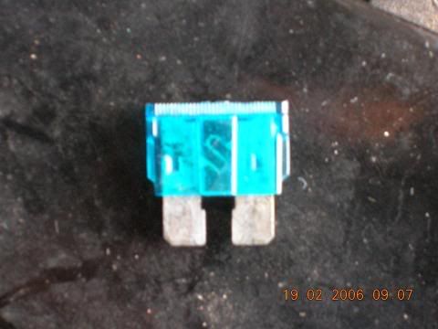

Postby Malcolm » Mon Feb 20, 2006 12:07 am
right, so here's what happened today:
Checked voltage at voltage sensing wire at the alternator, with key ON but engine not running;
9.8V when the rest of system was around 11.8-12.2V, looks like a probable cause
Checked voltage of same wire at the begining of the engine harness, where it plugs in to the chassis loom;
9.8V
Trace wire back to fuse box, pull AM2 fuse and check voltage on battery feed side of the fuse;
12V
A ha! So it's losing voltage from the fusebox to the end of the chassis loom? Check resistance of wire, $&#$% all, around 0.1ohm
So I check resistance of the fuse - no reading at all, not even on the highest scale on the multimeter (200M!)
So I swapped in a new fuse (old one was wrong rating anyway, 15Amp when it should have been 7.5Amp), and viola, no more overcharging!
This is the offending fuse, it was transmitting current, it's clearly not blown, but somehow it was causing a massive resistance

Postby Malcolm » Mon Feb 20, 2006 11:36 am
nah because it's only used as a sensing wire, and the current would have been very low due to the high resistance so it probably wouldn't have blown, even if there was a smaller fuse (like 5amp) in it. And if the fuse HAD blown, the alt would've seen 0 volts and overcharged to like 24V or something!
