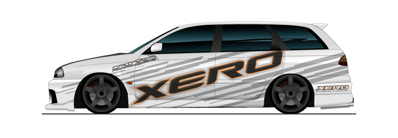

Postby XERO » Tue Feb 21, 2006 2:34 pm
Santa'sBoostinSleigh wrote:when/if you do it, take some piccies :)
Yeah or i can just draw it...
And a major PITA aye? hmm... maybe i can befriend a panel beater??...

Postby Santa'sBoostinSleigh » Tue Feb 21, 2006 2:46 pm
dem be some big brakes in the back....

Postby XERO » Tue Feb 21, 2006 2:49 pm
Santa'sBoostinSleigh wrote:dem be some big brakes in the back....
With the advantage of getting the rails off there will be better aerodynamic efficancy and weight loss, so ill need that extra stopping power :lol:
