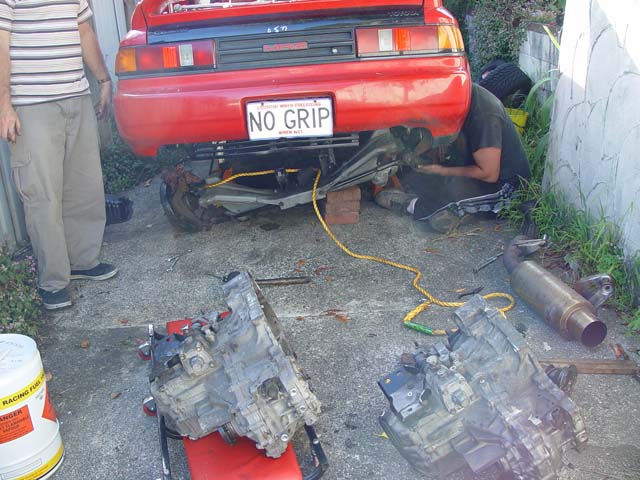

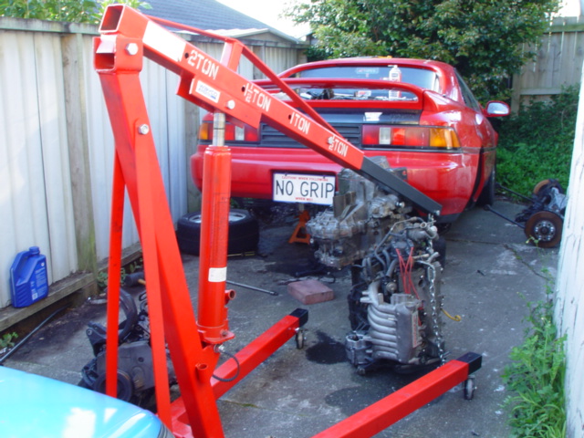

A hoist, couple of blocks of wood and some old wheels make light work...
Not an SW20, but same principle :wink:

that is some funny shit from where im sittin :lol: :oops: :lol: :oops: what did u need the hoist for ? the car? i picture just wheel n it out underneth on some skatebrds i cant see me needing a hoist ah would b handy of course but i havent got one do u reckmend i borrow 1
handy pics cheers i will do the same i can only open the drivers door 2:(
