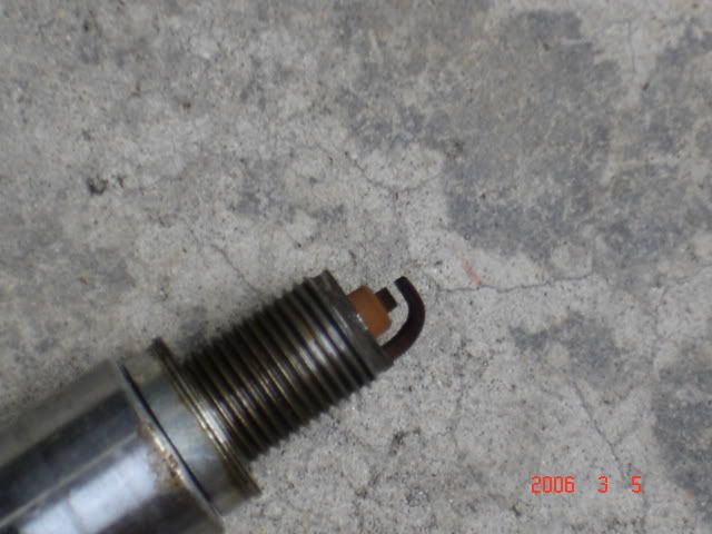

Okay, when cold the engine runs fine (ae92 fxgt)
When warm, it starts to jerk foward (like its missing) but its the engine cutting in and out very quickly, its gets worse and worse to the point where you are un-able to drive the car no more..
I have done the following:
Switched the ECU with another.
New dizzy Leads
New Dizzy
New Sparkplugs (which are now red??)
New fuel filter
Replaced Coil
Checked timming (its fine)
Switched the MAP sensor
Switched the ignitor
Any other idea's?!?!
Injectors maybe? Fuel pump, if so how do i check these two for faults rather than replacing it first.
Help.. me.. please? :lol:
Edit: When its cuts in and out, the Needle on the Rev counter jump up and down, up and down

Postby deaf_rattle » Sun Mar 05, 2006 4:13 pm
what makes spark plugs go a reddy colour?
they shouldnt be doin that after 1000kms
anyone?
Postby Zyros » Sun Mar 05, 2006 4:39 pm
Thats what they look like after 1000KM or so, i replaced the spark plugs last month thinking this was the problem.. obviously not.

Postby RedMist » Sun Mar 05, 2006 8:28 pm
The red coloration looks to be rust. However a BHG shouldn't cause an engine to stall.
My bet is there is still a critical earth problem. Not an issue with the ECU but an earth problem with ECU, injectors, ignitor, etc.
