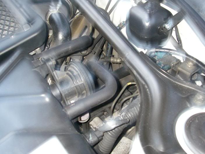

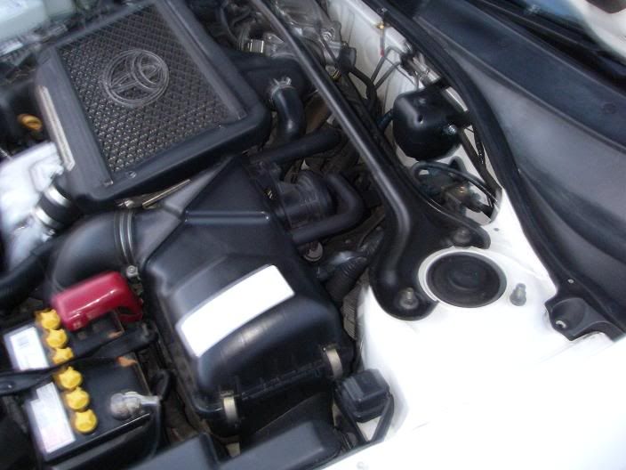

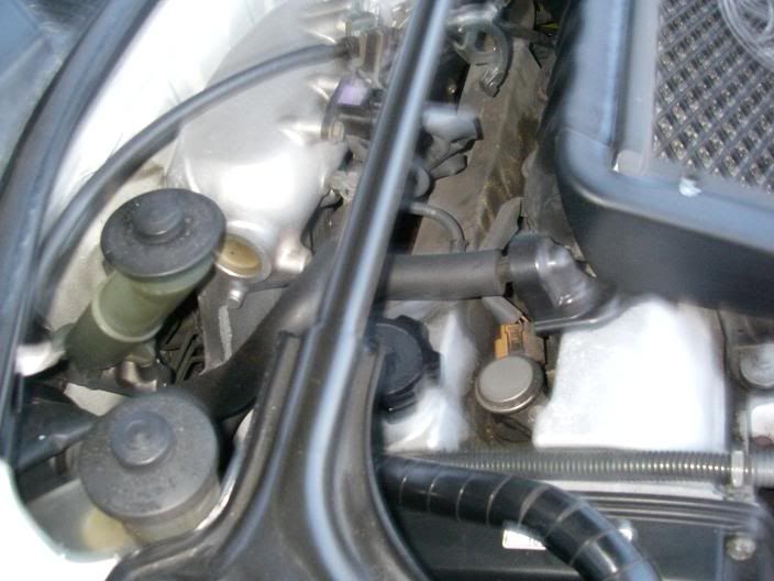

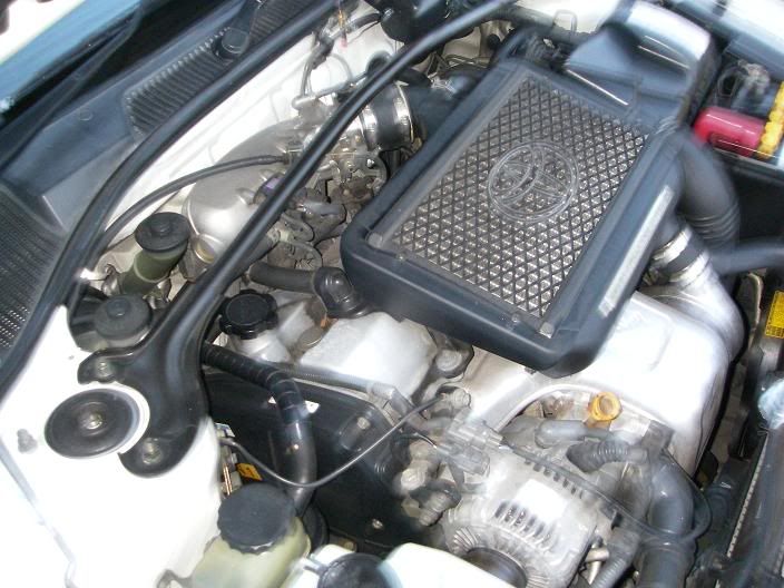

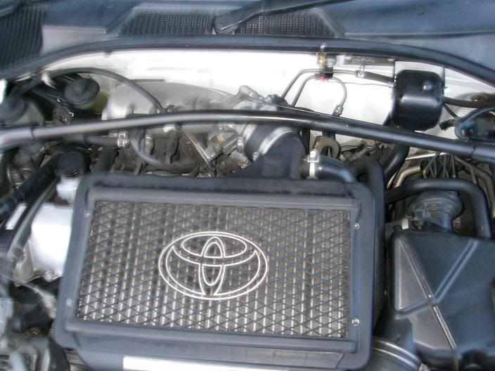

Hey, i got a autometer mechanical boost gauge and not quite sure where to plumb it into. i had a look at one post on the forums with a picture of it but wasnt too clear.
i have a couple of photos of my engine bay and was thinking if maybe someone could highlight which hose to plumb into would be much appreciated . Sorry for the blurry pics, it was dark and i upped the iso on my camera so it would be a bit brighter.

i think you will find allmost any non if all non liquid pipes will be suitable providing theres no one way valve on it.
Look for a vac line on the firewall > back of the plenum

Adydas wrote:i think you will find allmost any non if all non liquid pipes will be suitable providing theres no one way valve on it.
Provided it's not the line to the MAP sensor, it should be ok. MAP sensor is bolted to the plenum and had a purple sticker on it (clearly visible in your last pic).
