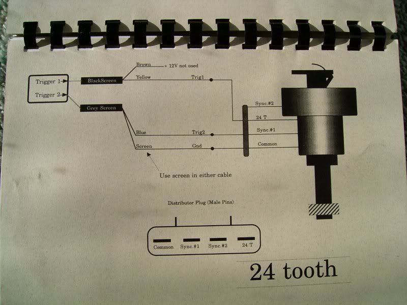

ok i'm having a problem getting a spark on my 4agte running a link v5, ity has lead me to beleive my wiring for the cas is wrong.
So wud someone be able to tell me where each wire from the cas before the plug needs to be wired to the wires in the screeded cable's?
from what i can tell after taking the cap off the cas is
white is common(goes to all sensors) goes to ? on the link loom
green and yellow are triggers?
red goes to ? on link loom
ne help wud b apprieciated
dylan

Postby suckymotor » Sun Apr 23, 2006 12:07 pm
have you looked on the link web site they have some info there or if not they do have a help foram you can go to
http://www.linkecu.com/support/dlandswu ... /Downloads

Postby sk1dlet » Sun Apr 23, 2006 2:16 pm
cheers for the link

Postby sk1dlet » Sun Apr 23, 2006 6:15 pm
well i finally got a a sync/cyl reading y and y so it's all go just gota wait for my battery to charge so i can try and star it ;oP
