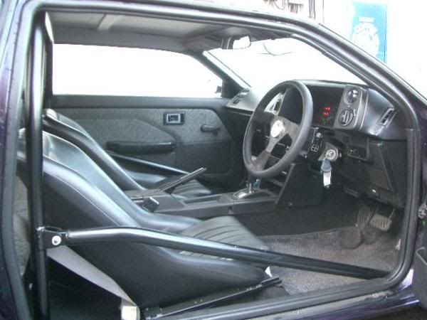

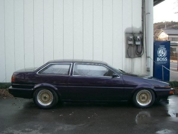

Postby NA Drifter » Thu Sep 21, 2006 3:41 pm
Keith
http://toyspeed.blakjak.net/profiles/profile.php?id=404
Austin Mini with 1275,TT140 Corona GT-TR with 3TGTEU, TE71 GT Levin with 2TGEU, AE86 Trueno 4AGE, AE85 Trueno 3A, Hilux Surf with 2JZGEU
NA Drifter
Posts: 1624
Joined: Thu Jul 25, 2002 2:43 pm
Postby sergei » Thu Sep 21, 2006 3:42 pm
It is very, very UGLY.
Postby scope » Thu Sep 21, 2006 3:47 pm
sergei wrote:It is very, very UGLY.
very
