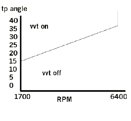

Postby sergei » Fri Sep 22, 2006 2:41 pm
The amount of throttle needed to activate the VVT varies (lineary dependant of RPM) it is the same for both pre-facelift and post face lift silvertop and very similar in blacktops (although switch off point is lower ~ 6800 vs 7200).
To activate VVT on lower RPM it is required less thottle than on higher RPM.

NOPE. VTEC controller is just an RPM switch, the stock system is far better option. You don't need to mess with it unless you have aftermarket cams., but then it becomes a head ache.
The system itself is very simple - 1 solenoid, 1 hydrolic pulley thing, 1 2d maped output.

I have a small picture that may help explain vvt a bit better
It shows where the vvt switches on and off on a revs vs. throttle potition graph

VVT is either on (Cam angle 15 degrees advanced)or off (0 degrees) no in between .activation point on silver tops is determined by TPS and rpm above 3000 -3500 while black tops use TPS, rpm above 1700 and map. i know black tops deactivate at high rpm about 7000 not sure if silver tops do this tho
VVTi (not found on any 20v 4age's) is constantly variable and adjusts the cam angle anywhere from - 15 degrees thru +15 degrees changing to always provide optimum cam angle
VTEC controllers only have activation point switching not allowing deactivation at high rpm and since advanced cam angle is only effective in the mid rev range VTEC controllers dont make good VVT controllers
