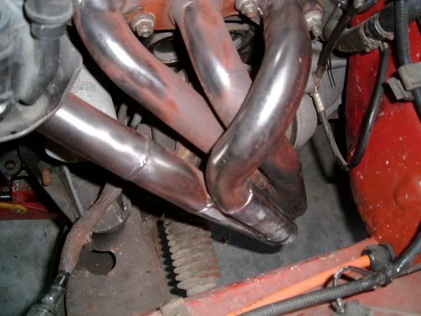

hey
this guys made my 4-2-1 extractors.
isnt this totaly the wrong way - like how 1 -2 pipes are joined and 3-4
shouldnt it be like 1-4 and 2-3 joining up. how much difference does this make, he reckons none and has done a silver top like this before.
im told it makes it have funny sound to it.
http://homepages.slingshot.co.nz/~jimco/images/extractors2.jpg
this is how it should be?? am i right?
churz

Primary's are in the wrong order,
and IMO the secondary's are too short.
matt

matt dunn wrote:Primary's are in the wrong order,
matt
cheers he said he would change it if i want
so is that bottom pic how they should be made?

I would say yes,
and if i was doing it i would not make the two pipes into one untill about 1 foot or so in front of where the front of the seat would be.

Postby fuel » Wed Sep 27, 2006 10:58 am
Each runner should be equal length too. Sounds like the guy has no idea what he is doing when it comes to designing extractors.
Even if you look on factory cast manifolds you will see numbers 1+3 and 2+4 are joined before going to the secondary or collector pipe.

Postby KinLoud » Wed Sep 27, 2006 2:32 pm
Don't stress too much about primaries being equal length. Within 15 to 20% will work fine.
If there is some variation in length it helps to widen the power band a bit.

Postby Caveman » Wed Sep 27, 2006 8:36 pm
And if your running an o2 sensor mount it where the 2-1 collector is, not just on one cylinder.

Postby strx7 » Thu Sep 28, 2006 7:02 pm
secondaries should be twice the length of the primaries shouldn't they?

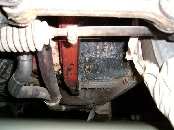

Postby QikStarlie » Fri Sep 29, 2006 7:08 pm
i made some out of coby 4-1's. extra pipe came from the local car dump and under the house..
half done
http://img.photobucket.com/albums/v178/ ... c_0016.jpg
2-1 bit
http://img.photobucket.com/albums/v178/ ... 000141.jpg
cost 0
