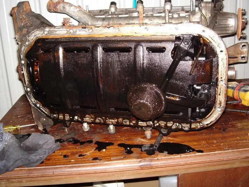

well im hoping to get some pistons out tonight and stuff... got the sump off... then i found this in the way....
can i remove this? do i have to angle grind it off? or just work around it? pain in the ass little piece of metal

Postby Lloyd » Tue Oct 03, 2006 7:29 pm
Should just come off. Get the pickup out of the way and go from there. Should come off easy enough
Postby AE85coupe » Tue Oct 03, 2006 8:34 pm
just pull it off, its probably only held on by some sealant, get a flathead screwdriver under it if you have to, every 4age i've pulled apart its just come off easily
like HRT said, get the pickup out the way first

Postby no_8wire » Tue Oct 03, 2006 9:22 pm
remove the oil pickup, slide a spatula between the metal plate and the block and after you have slid the spatula all the way around pull it of. Becareful not to bend the flange as this will cause leaks when you reinstall...

Postby Psycho_Dad » Tue Oct 03, 2006 9:47 pm
kinda carefully managed to pull it, its too late pull pistons tomorrow and get block to machine shop
