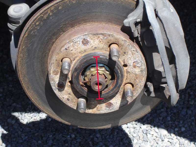

Im trying to fit new wheels to my gfs Starlet Glanza (Non turbo). However the wheels Ive got which are 15" SSR Type Xs with the correct PCD and offset wont fit the car.
The centre piece of the hub that sticks out is about 2mm in diameter too wide to fit into the centre of the wheels. This is more than I want to grind away from the wheels but what are my options for modifying the hubs.
Is there anything wrong with either taking off that piece of the hub or putting it in a lathe and reducing it in size abit.
See picture for explanation

those bits arent spose to be there anyway. looks like an adaptor ring from the wheels you have taken off is stuck on there. that part of the hub should be 55mm.
should be able to bash it off

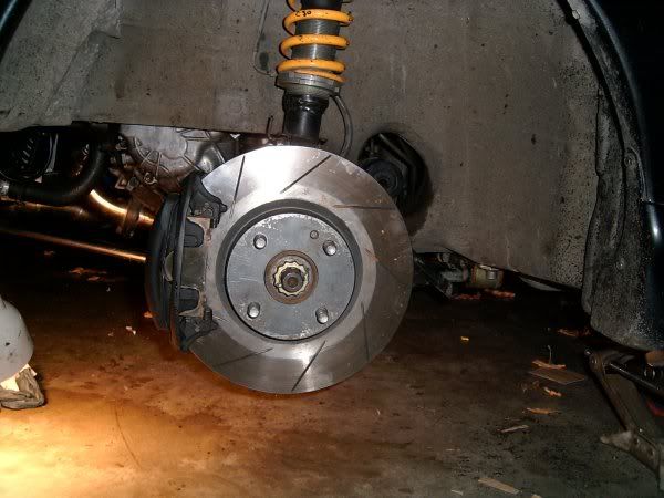

should look like this (brakes in pic not stock)

haha so it is, cant believe I didnt notice that!!
you can see the rusty ring in the center of the spacing ring, nice one :lol:
Postby Bullitt » Thu Dec 28, 2006 9:41 am
Thanks very much. Wheels are now fitted. That saved me alot of (further) unnecessary mucking around :oops:
