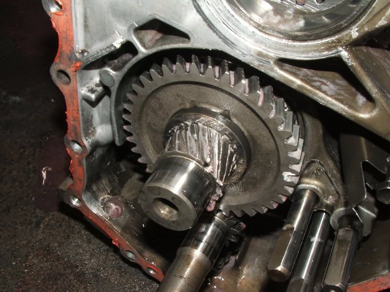

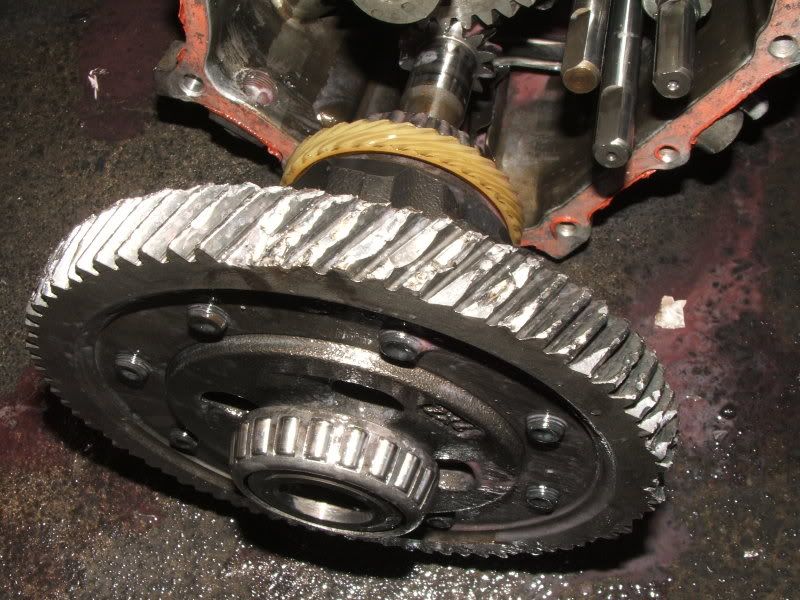

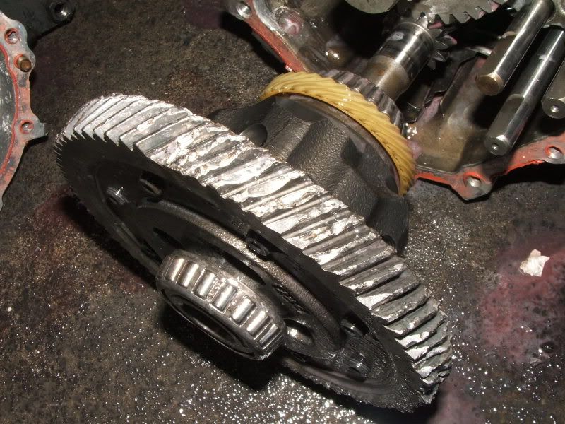

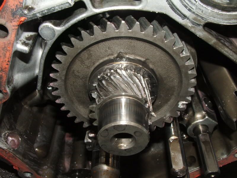

Postby sergei » Sun Feb 18, 2007 6:23 pm
Ok I have pulled apart my blown C160, here are the pictures:
Postby flygt4 » Sun Feb 18, 2007 6:27 pm
ouch

Postby sergei » Sun Feb 18, 2007 8:05 pm
bluemaumau wrote:what a rapist :wink: :lol:
I didn't even try :oops:
