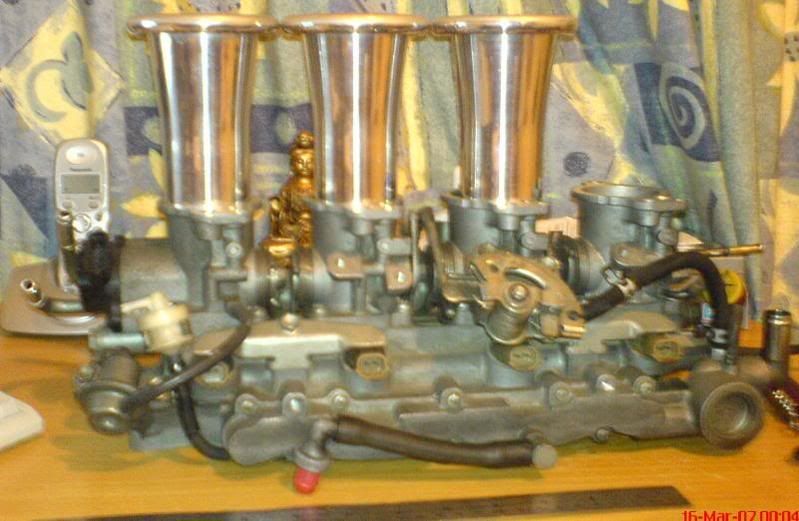

any one know of a brake booster that is much thinner then the ae86's big balloon sized one? or even if its smaller in diameter. has anyone used one from another car that will fit. i just got some sexy velocity stacks the other day, they are 110mm long and don't really want to cut them down. but may have to if i cant find a smaller or thinner booster. any help would be great thanks

thaphatty; yea i was thinking something like that, but instead of milling the stacks flange i was thinking of milling the manifold between the quads and head to point the whole throttle body unit upwards that will also give better flow into the port as well(bonus) but thats way too much work just to fit stacks, maybe in the future.

I'll get some pics of the velocity stacks up to show everyone why i don't like the idea of cutting them. they look so damn good everyone i show them to want to steal them when im not looking :(

the pic does not do them justice.
