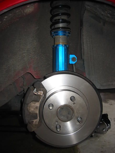

Postby IH8TEC » Mon Mar 19, 2007 8:20 pm
here's a pic of my gtz rear, the calliper is towards the front of the car
hope that helps, just a note, my rear pads have hardly been touched at all, and been through 2-3 sets of front road/race compound pads
Postby Hachiroku » Tue Mar 20, 2007 11:17 am
Thanks for that, you're a legend! My main concern was to do with having the handbrake cables operating at the correct angle (I assume this is fairly important?)

Postby Mr Revhead » Tue Mar 20, 2007 12:15 pm
i have read a bit about how brake caliper location can affect the performance of a wheel under braking
i doubt you will feel it. and it makes less difference to a live axle.
just mount it so the cables are unrestricted.
to get an idea about how a caplier effects a wheel, just think of the forces and the way they move.
remember newtons laws of physics!
