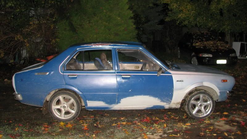

Postby 79rolla » Tue May 22, 2007 9:43 pm
been talking to my dad bout mu car and he says that i should just put some reely good shocks in it and there is no point lowering it even a lil bit with some harder springs
is he right? lol
thnx

Postby 79rolla » Tue May 22, 2007 10:24 pm
im looking for handiling mainly here (i live up a hill in the country) so looks arnt comming first for me
the suspention is shit at the moment so cash is gonna be spent on it anyway

Postby 79rolla » Wed May 23, 2007 10:54 pm
dont like the understeer and pasengers dont like rool (not that i notic lol) apparintly it rocks and bounces (agen i dont notic driving) my road isint relly bumby but its not the best in the world and there is lots of corners
so yea want some better traction and car to sit a bit flatter if you get what i mean
oh yea just so you no its got DX struts in the frount and to sum up the current suspention... sponge :oops:
