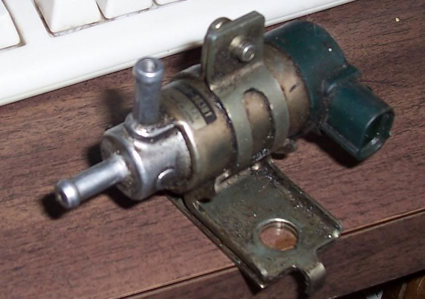

Now i found another leak (i think). On the TVIS plate, theres from left to right, a blue canister, a smaller silver canister then the TVIS valve etc. Now, the small silver canister, it has an electrical connection (greeny plug) and 2 vacuum lines. One comes out the end, the other out the bottom. The end one goes to a metal line from the intake manifold, where does the bottom line come from? I cant find it, and i suspect this could be the leak...
Ill get pics tomorrow if need be, its raining too hard now :?
Postby Boosted_162 » Wed Jul 04, 2007 6:02 pm
Postby sergei » Wed Jul 04, 2007 6:06 pm
this is factory boost solenoid. it bleeds boost to atmosphere (bottom bit not connected to anyhting).
