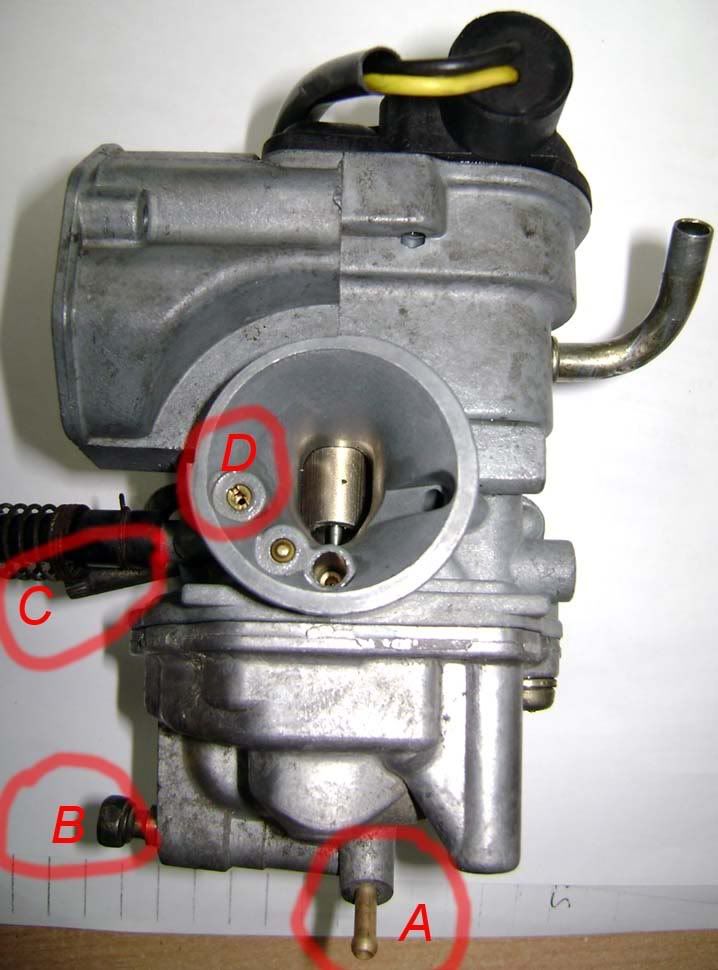

I have pulled apart some of the bits from it and noticed that the carb was missing 1 hose completely.
The A did not had a hose at all, is it a drain of some sort regulated by B?
Is C idle adjustment? (it looks like it is going right through and sticking out inside so the "throttle" stops on it).
What about D? Mixture adjustment?
Postby ATAl » Wed Sep 05, 2007 2:40 pm
Just a few rough guesses from what the carb on my bike looks like:
a: this will be a fuel drain / breather pipe - no need for a hose but a good idea to get the petrol away from a hot engine...
b: possibly a float level adjuster - I've got no idea really.
c: yep, idle speed adjuster
d: I'm never sure which is which, but that's either the pilot jet (for closed or very small throttle opening mixtures) or the idle mix screw, whichever one it is, the sunken one to the right will be the other.

Postby CaM » Wed Sep 05, 2007 8:28 pm
c is idle mixture
the one with thespring on it that's slightly coverd = idle speed.
d=jets = o idea. one's likely a pilot jet, other may be an air correcter vent for flaot bowl? duno. all my bike carbs are different.
b = screw for drain valve which drains out of a.
a = dont need a hose off t. jsut a drain.

My sepias dont have washers on the cvt to limit the speed so I assume they all don't, there is a little spring though that supposedly slows the scooter down and you can replace with a softer one but I never did and mine can go 80 km/h on a good day. The thing that hold it back is the exhaust, if you pull it apart and clean the inside then put it back together and drill some more holes in the end it will get a bit more go out of it.
That carb scares me aye, its so complicated. we figured out though that the yellow and black wires operate a wee solenoid in there maybe for a cold start or something.
