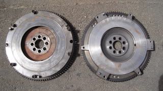

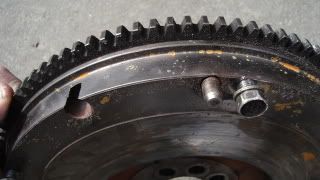

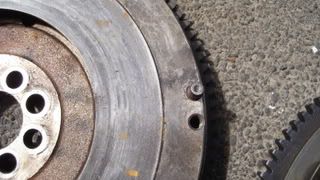

Postby crispy'86 » Sat Oct 27, 2007 3:05 pm
some pics of the comparisons. Blacktop flywheel on the right, bluetop on left of the flywheels beside each other. The first 2 pics are the bluetop flywheel, 3rd blacktop one
you can see my concern now that you've got proof of how much has been machined off the bluetop unit

Postby crispy'86 » Mon Oct 29, 2007 12:16 pm
AceSniper wrote:blacktop one looks safe, guess its had a very light skim, but were its been done it wont effect strength I doubt :twisted: :twisted:
BZG|Bling wrote:that post confuses the s**t out of me bro, you sure the blacktop is lightened?
So you see why i think the blacktop has been slightly machined/skimmed. You all can see how i feel the blacktop unit is the one i'd feel safer to use for obvious reasons.
