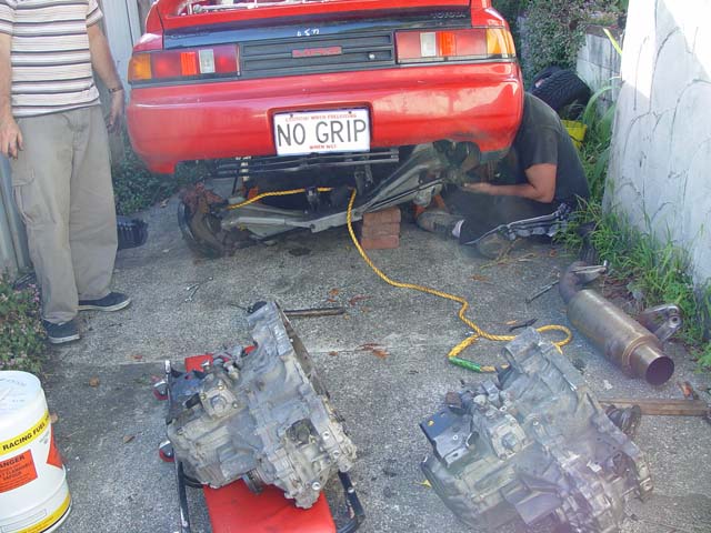

Postby thegreatestben » Thu Dec 27, 2007 1:57 pm
that photo brings me chills, all too familiar with MR2 gearbox swappage.
