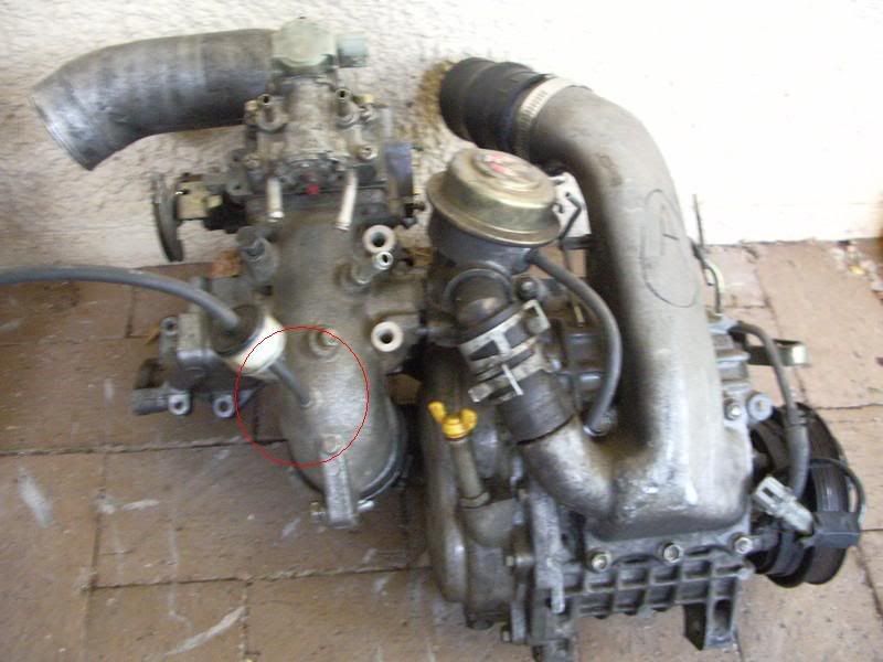

Hey guys, I have a 4agze bigport AFM
THe vacuum nipple on the back of the intake manifold has snapped off so i cannot connect the vacuum hose.
What i wanna knowis if this is important or is simply for emission controls? will it affect the performance of my engine?
Also my engine has a very rough idle at the moment. What could this be due to?
Have done the timing and idle adjustment but still seems to be very sluggish and idle is flucuating rapidly.
What could be the cause?
Thanks
Calvin

Any ideas .. the small nipple has snapped off and due to its location is not easily put back on. i wil try find a pic.
Calvin

Postby Calvin » Tue Jan 15, 2008 7:33 pm
Have found where the nipple is. not on the manifold but still on the intake. How easy is it to remove this part?

Postby Pelo » Thu Jan 17, 2008 12:30 am
I'm pretty sure that particular hose goes to the blue supercharger VSV. Part of the boost control system. You can simply block the pipe.
This page may help
http://www.mr2supercharger.com/ABVmods.html
