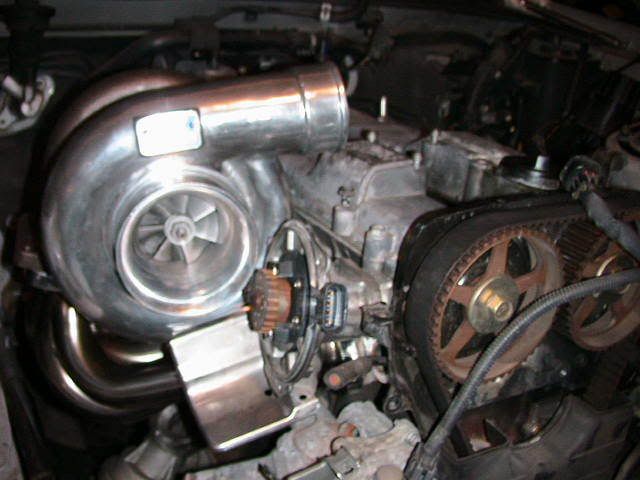

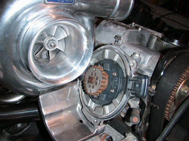

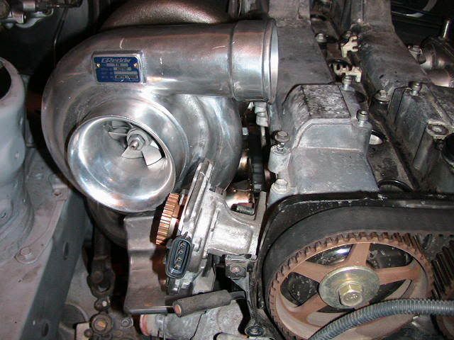

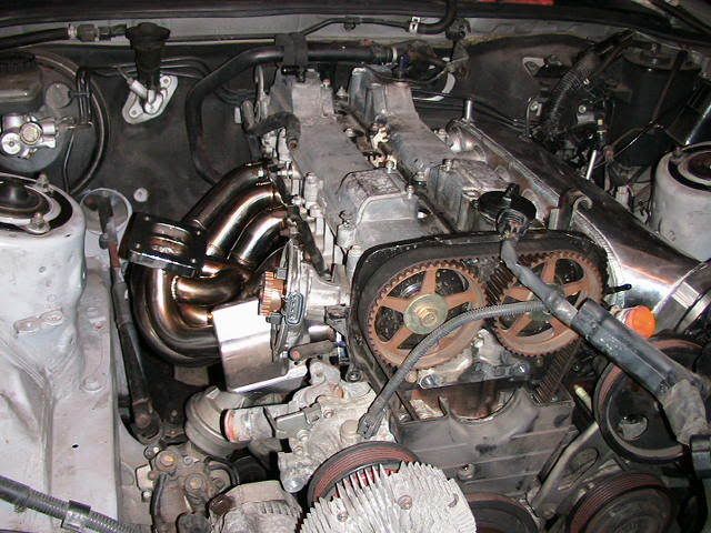

Postby gtpornstar » Sun Apr 13, 2008 12:53 am
yeah problem was where to get the crank angle sensor reading from. Have now found out can try mount a turbo sensor onto the intake cam or have to try something like what the C&M supra does with entire dissy on the front of the exhaust cam.

gtpornstar wrote:yeah problem was where to get the crank angle sensor reading from. Have now found out can try mount a turbo sensor onto the intake cam or have to try something like what the C&M supra does with entire dissy on the front of the exhaust cam.
I have seen people putting the dizzy on the front of the cam on 20v 4ages, looks to be a lot of work tho. The only reason I see to do it would be to use the factory ECU. The dizzy may rotate in the other direction to the front of the cam too?
It is quite easy to add a crank angle sensor. As ChaosAD said, you just need to add a toothed wheel and a VR sensor.

Postby gtpornstar » Sun Apr 13, 2008 11:39 am
ChaosAD wrote:You could probably use edis and weld a toothed ring onto the crank pulley.
Why are you changing the pickup in th silvertop dizzy?
All you need to do is either grind two opposing teeth off the 24 tooth wheel and use it as a 12-1 wheel. Or make a 2nd vr circuit and leave the dizzy as it is.
Sorry should have explained, its not for a silver top but a 2JZGE (non turbo 2J). I actually just need one tooth because it has a crank sensor so the ecu just needs to know when the cam is at TDC for number 1 (using aftermarket ecu).
