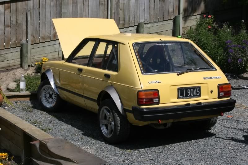

Postby GDII » Fri Feb 01, 2008 1:14 pm
Yea! Flares like this lol

yes, something like that is what i need, i was thinking more like this:
if anyone knows somewhere in auckland that does steel or fibreglass panel work like that, let me know, since stuff *really* doesn't fit with my custom arms i have in the shed.
