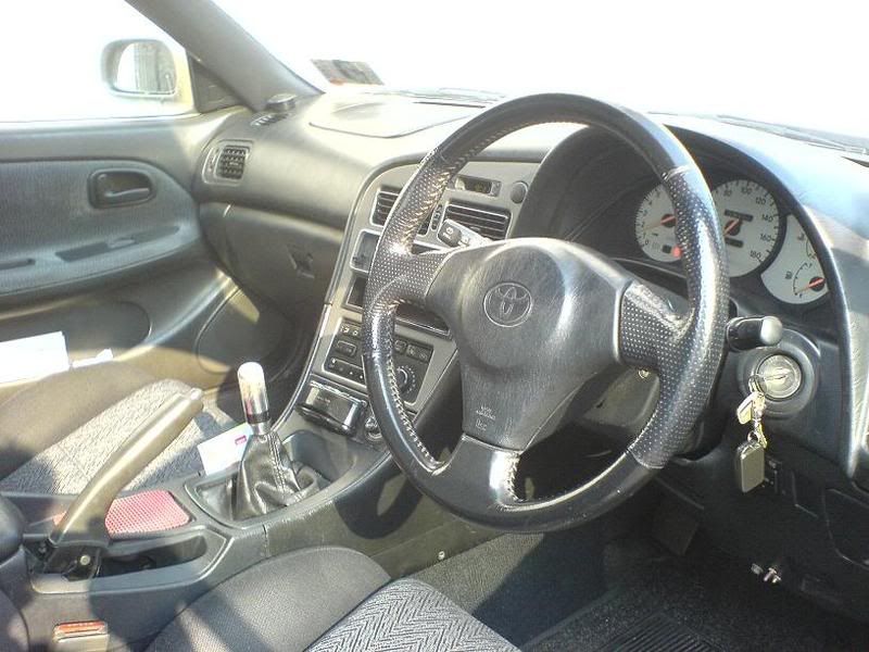

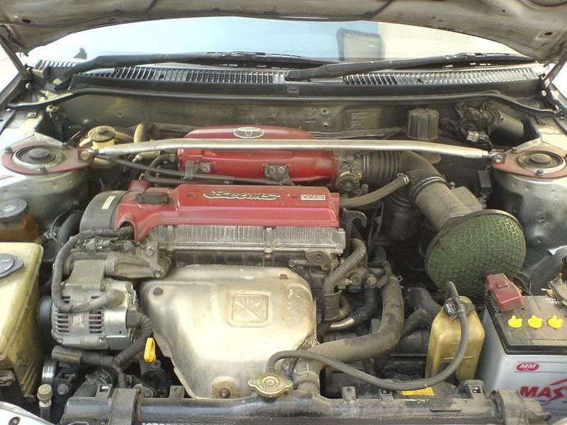

if you want to be different instead of going 3SGTE way, go 3SGE beams (red-top) way, it will be more drivable, more reliable, more economical, and will be a lot more fun on twisty roads.
Postby normality78 » Mon May 26, 2008 3:57 pm
like this

as a side note what 'colour' do you call the beams engines in the caldina gt's?
Postby sergei » Mon May 26, 2008 4:43 pm
xsspeed wrote:as a side note what 'colour' do you call the beams engines in the caldina gt's?
As far as I know it is the same engine, just design department decided to paint it silver.
Postby xsspeed » Mon May 26, 2008 4:53 pm
yeah thats what i thought, though i read somewhere of a 'grey top' but that didnt produce as much power, but that didnt seem right. (note: may have been wikipedia, the most reliable authority on everything)
