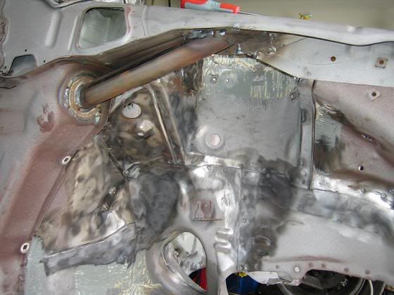

3T-Rona wrote:I also would like to put braces between the base of the 'A' Pillar (under the gaurd) and the part of the body where the top of the gaurd mounts (45o angle?)
Which you wouldnt be able to see once the gaurd is on......
Good idea?
Would the under dash brace be viable?
Joseph
Like this?
i would have thought that 45deg from the base of the A-Pillar to the height you suggest would almost certainly run through near around where the wheel would be and would be visible.
Good idea?
Joseph
Like this? Image
I was always wondering what this is for.
My evo had this brace, it was not a atandard one but a chunky tube
It didnt cut through anything like that, just ran behind the guard from the base of the a pillar up to where the guard mounts..

Postby 3T-Rona » Wed May 28, 2008 8:55 am
yep that sorta thing (45 was just an 'off the top of the head' thing)
but also my 'under gaurd' area is a tad different.
Would that pass through certification?

Postby Distrb » Wed May 28, 2008 9:30 am
3T-Rona wrote:yep that sorta thing (45 was just an 'off the top of the head' thing)
That case in particular doesnt need certification as it is part of a full rollcage (runs through and connects to the front legs) so authority card covers it. 8)
Best to put it to your local certifier and ask. then you can report back with what you find and tell us all. 8)
