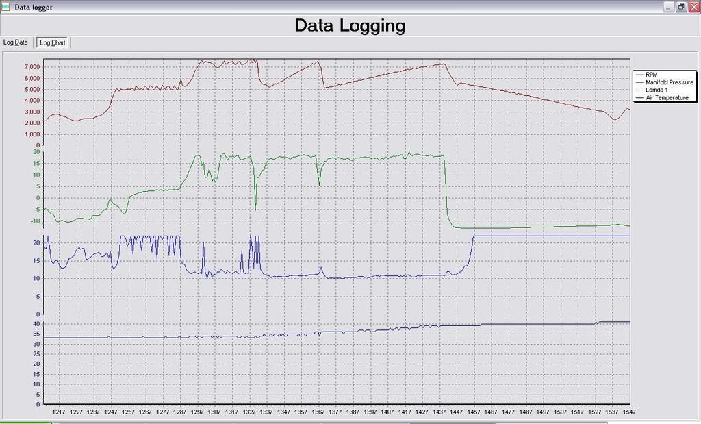

Postby cat007 » Mon Jun 09, 2008 7:53 pm
here's a screen shot of some of the data log.
bottom is intake air temp.
1247 is staging with launch control and 1287 is me taking off down the strip. I'm sure you'll be able to figure it out from there :P
Postby RedMist » Mon Jun 09, 2008 8:42 pm
I dont know how applicable it is. But I run two silly aftermarket MR2 intercoolers in my offroader. I was very scared about thier efficiency so I placed an IAT before the intercooler and one just before the TB.
On the dyno (ie little air flow) it ran 70-75 degrees before the intercooler and 21-25 degrees after. This may be the very clean path for airflow as there isnt anything behind or before the intercooler.

Postby fivebob » Mon Jun 09, 2008 9:12 pm
20-25°C sounds about right if the temp after the turbo was only 75°C.
Typical turbo outlet temps are usually in the 110-130°C range and around 40°C would be reasonably efficient and certainly nothing to worry about.
