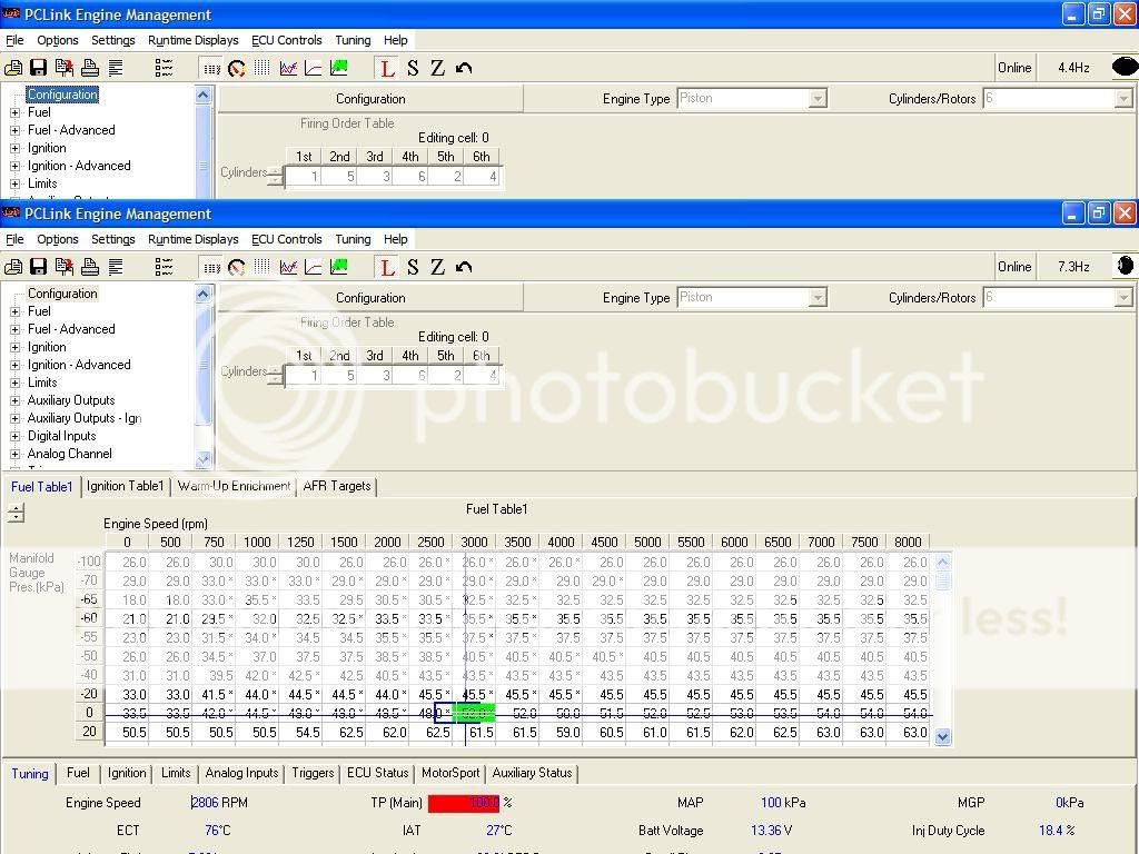

What happened was i drove it into garage was running fine, removed fuel pump as the standard struggled to keep up installed a walbro intank pump and a sard FPR(removed standard one). Set fuel pressure to 40psi on idle as that what i was told to set it at.
Now when i plant my foot it coughs and splutters, does not smell like fuel after putting reg in and the psi does not drop much when you put your foot down.
It does not hit boost at all according to the laptop but the boost controller reads like 0.5psi etc..

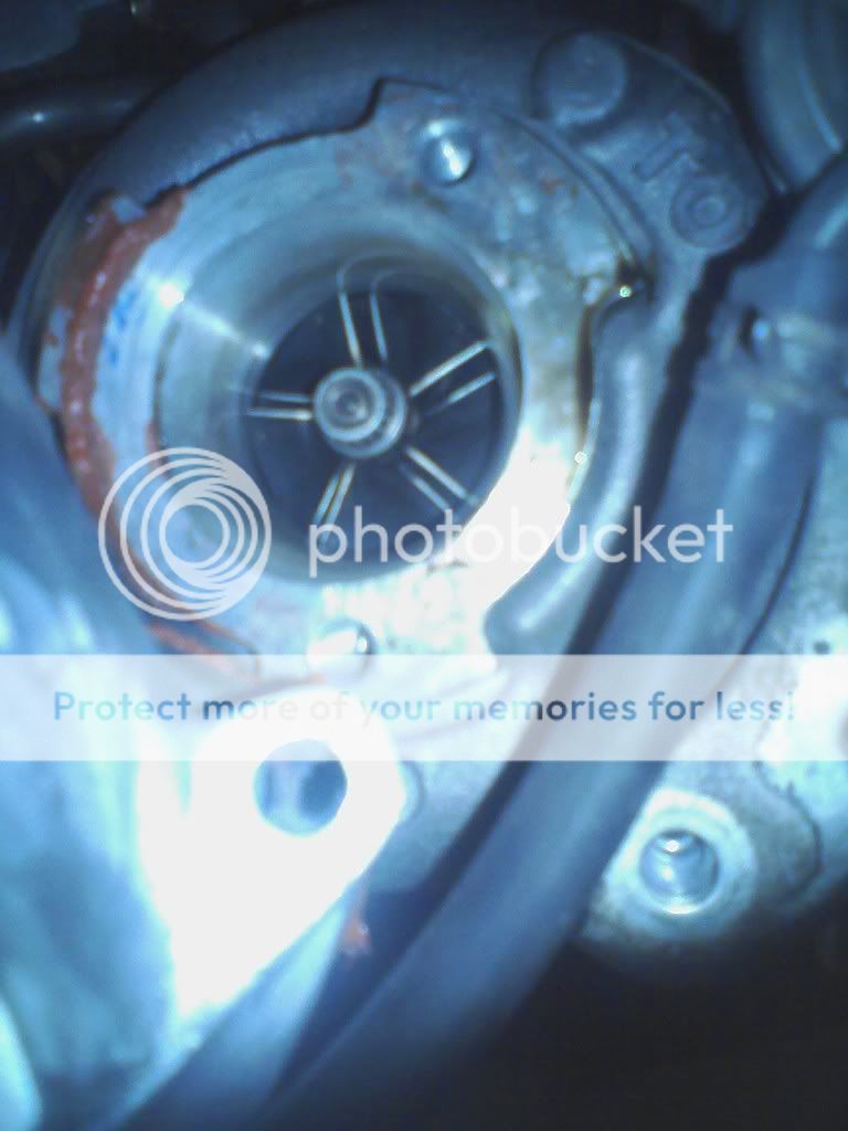

Now there are no boost leaks ie intercooler pipes off split hoses etc.. thought the turbos cud be stuffed but just pulled off front housing on front turbo and spins freely like it should no and impllor didnt appear to be damaged. (This does not eliminate the back turbo) but i should still get boost as each turbo runs off 3 cylinders right ???
All the spark plugs are clean and coil leads connected properly etc..
The weird thing is you can rev it up to about 4000rpm 4500rpm but when you plant you foot it just coughs and wnt get past 3000rpm.
Here are some pictures when the computer was plugged in.

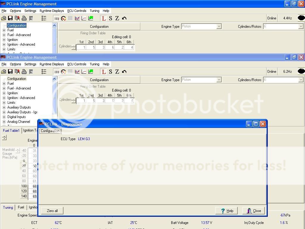

IS THIS HOW THE DIAGNOSTICS IS SPOSED TO WORK ??? a blank box or what am i missing or is the computer not picking up anu fault codes
At idel

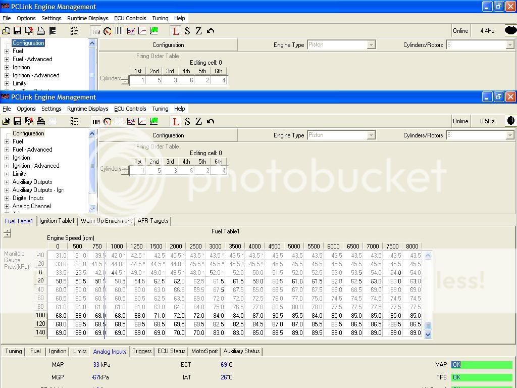

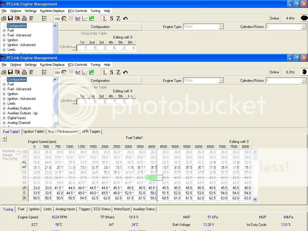

slowly bring up revs
Putting foot down hard
Diagnostics which I dont no how to work or brings up nothing
And a photo off my phone of the turbo.. impeller seems to look ok feels good spins freely but no boost ???
