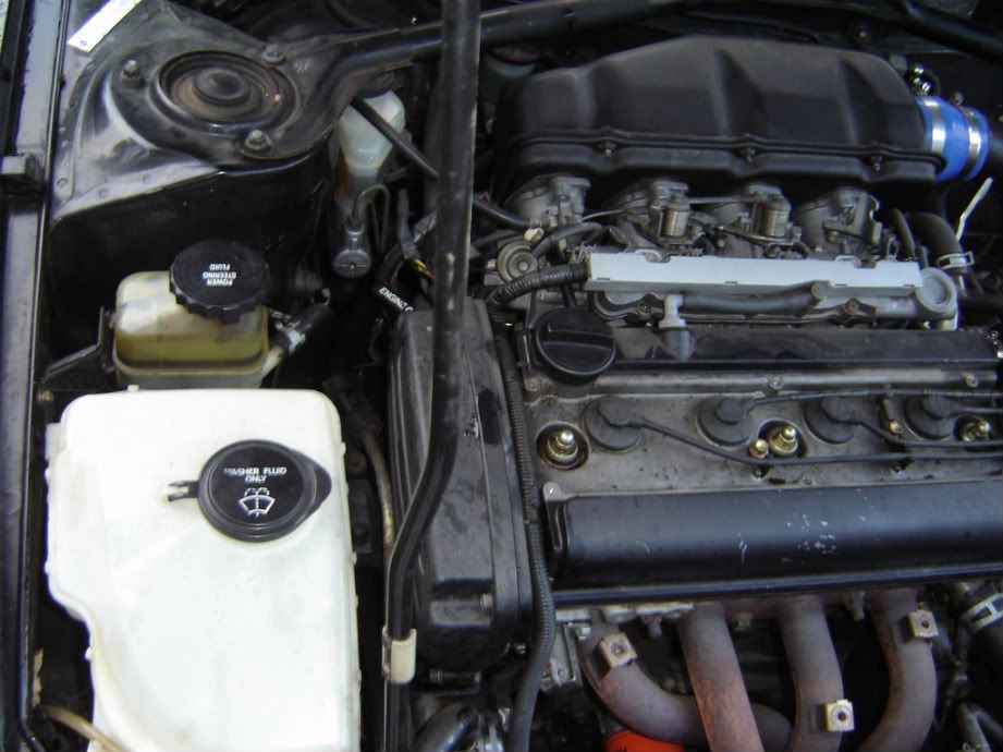

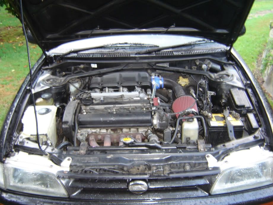

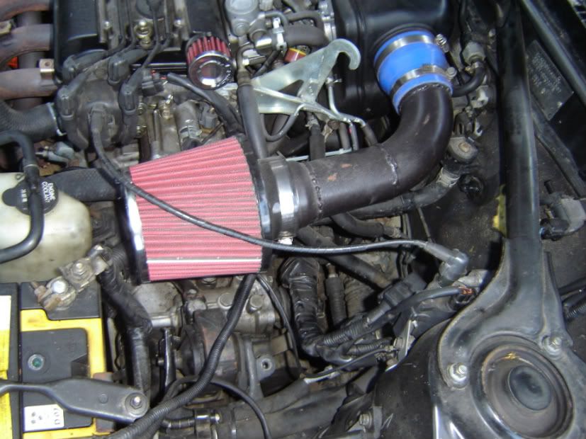

Postby Bling » Wed Feb 11, 2009 11:36 pm
Something is not right there at all. You shouldn't be losing power.
Have they used a silvertop loom and ECU as well?
Can you take a photo of your engine bay by chance? Could shed some light as to how the intake is setup etc.

When I bought it I had to rebuild the engine. We found the timing out, wrong spark plugs, an ecu out of a 98 corrolla , white spark plugs and an exhaust leak on cylinder 3 (low compression).
So since then it's had done:
New head
Rings and bearings
Blacktop ecu
Iridium sparkplugs
Correct timing
Reconditioned VVT unit and new seals
It goes very well 98% of the time it's just the detonation problem to sort out now. How could I tell if it running the correct loom? My feeling is that Crampy is right. It's the pod filter and lack of air temp sensor thats the problem.

Postby neo » Thu Feb 12, 2009 9:13 am
+10 Points for a blacktop in a 101FX
-5 Points for the air intake
-3 Points for the PCV valve still being plumbed into the inlet runners for the return.

Cheers, but what do you mean by the last point?

Also I'm thinking about getting a standard blacktop or silvertop air box becasue that pod filter is just horrible sitting there.
