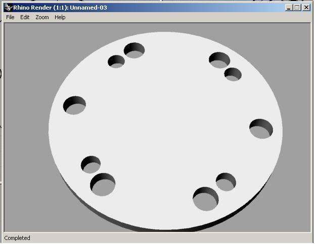

another possibility is to make an adapter plate similar to wheel spacers that change stud pattern.
like this:
