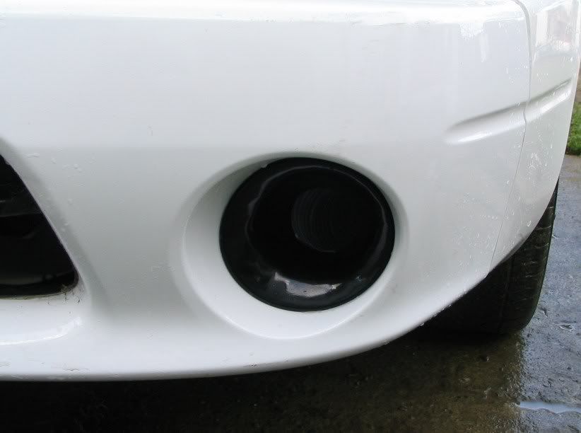

Postby jetshin » Wed May 06, 2009 9:34 am
Here's something I did which cost me hardly anything and improved performance a little (although might placebo :lol:) . inlet connects to some ducting which leads to the factory airbox.

Postby MR2BOY23 » Wed May 06, 2009 9:39 am
^^ That looks really cool

Postby Kittah » Wed May 06, 2009 10:01 am
MR2BOY23 wrote:^^ That looks really cool
+1 on that! When I get around to giving my car a Facelift makeover I'll definitely do something like that. Very slick 8)
