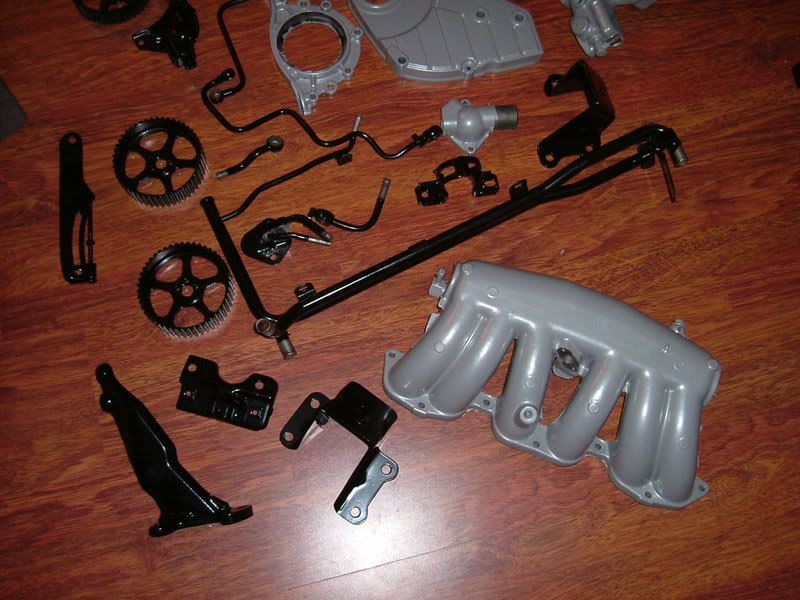

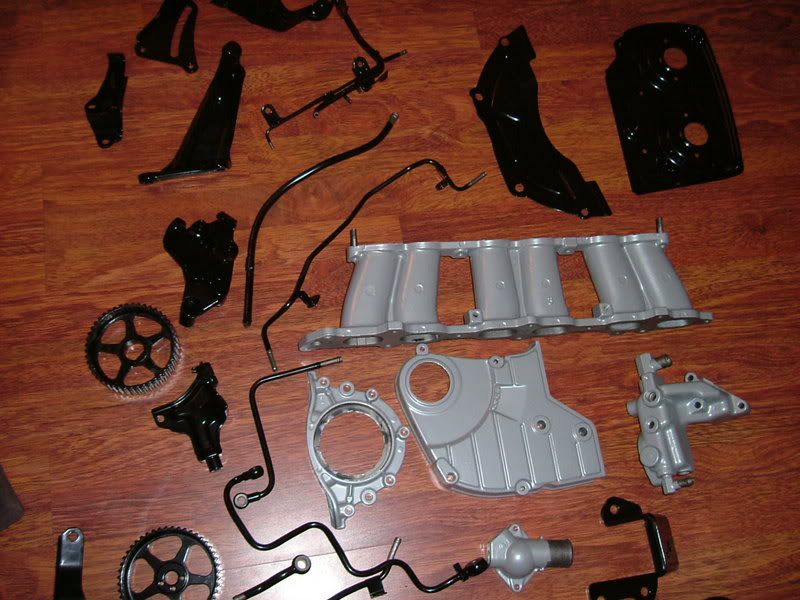

Postby blackmk3 » Sat May 16, 2009 9:51 am
^ That looks ugly having 1j parts on a 7M, easy to make your self, well i did and i aint no welder or engineer, biggest issue was bonnet clearance. I just made sure when making it that all the openings into the manifold were all of equal size, runner length is the same for all. Been on there for around 30,000kms now and all spark plugs are the same color
I PM'D you some pics of my build a while back Matt
But in general its the best thing i ever did, clears up the engine bay, spark plugs are easily accessible, intercooler pipes are easy
I have a MA70 however
Nick
