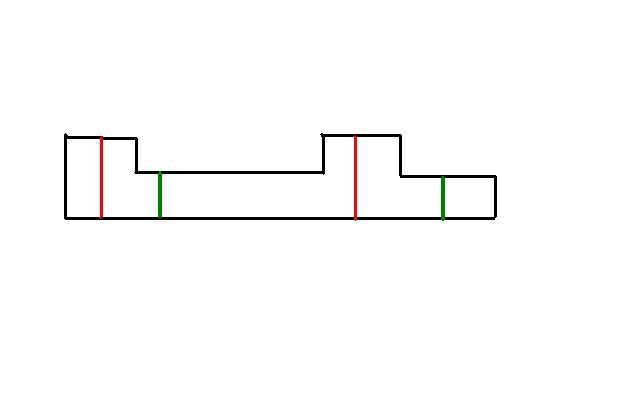

Also - I require it to be stepped - like the pic below (that would be looking side on, (red lines are where the caliper bolts go through, green are where the hub bolts go through)). I was wondering if it would be ok to just use a single flat piece of plate steel/aluminium and then just space out the caliper somehow - or should It all be one piece?
Cheers :)
Postby mjrstar » Mon Aug 24, 2009 2:15 pm
1 piece, flex is bad.

Postby cat007 » Mon Aug 24, 2009 2:19 pm
mjrstar wrote:1 piece, flex is bad.
Aluminium would be ok? Even if pricier?
Postby Bazda » Mon Aug 24, 2009 2:21 pm
Depends how thick that plate is. And how long it is.
Cheapest way is to make it out of 1 flat piece, then get spacers lathed up to the required thickness.
If you make it out of 1 thick piece then there will be machining costs involved.

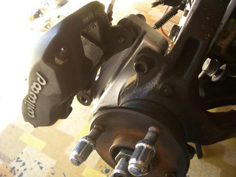

Here's some pics of the mock up :)

From your pics... doesnt tell us anything about how to make the adapter plate really lol
Postby cat007 » Mon Aug 24, 2009 2:52 pm
Bazda wrote:I'm not sure how thick you would need to go... but mine are 20mm thick at the thinnest point and 35mm at the widest. Also with a huge radius on all edges.
Nah I know - I haven't taken any decent pics yet. Just wanted some of the caliper and rotor in place :)
I'll take some decent ones tonight
