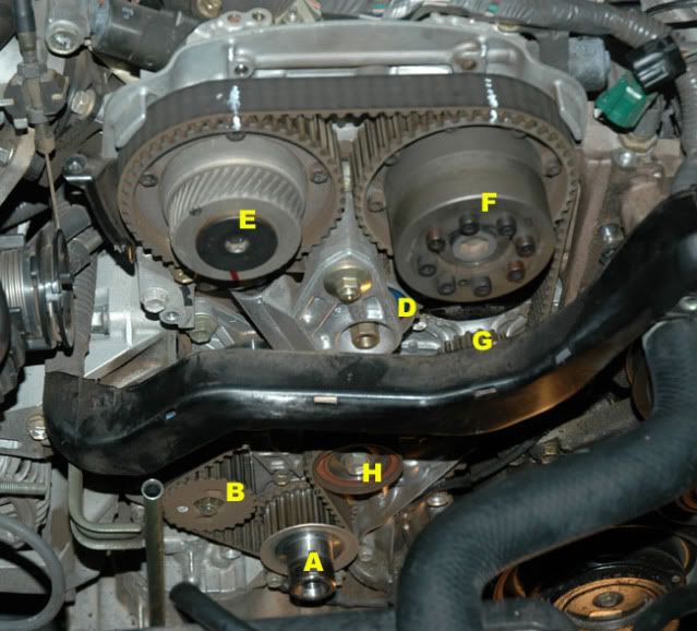

you need to take off the covers marked E (10mm hex), and corresponding one in the center of the exhaust pulley (14mm hex) which exposes the 12mm hex bolts that hold the pulleys to the camshafts..
undo those hex bolts and then you should be able to slide the pulleys off.
if you dont take the pulleys off, then you wont get the solenoid housing off as the pulleys have a collar that slides over them. its hard to describe, but when you get the pulleys off, you'll see what i mean.
