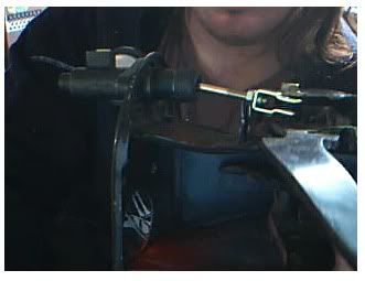

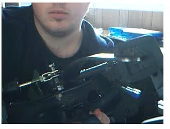

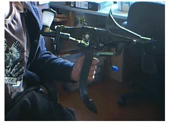

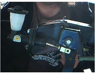

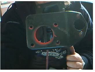

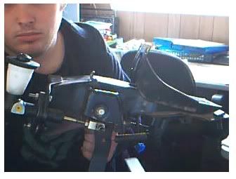

as a follow up from last thread in the end i took the whole peddle box out
and as i was warned in the past the hole doesn't match up with the peddle
thinking about just welfing a bracket on, this should work. or does anyone have any better ideas?

Postby l1ttle_d3vil » Wed Jul 22, 2009 6:44 pm
yeah just weld a lug on the side of the pedal which you can attach the push rod to. only needs to be about 1" - 2" long.
I used a piece of round steel about 1.5" long, welded it on the side of the pedal, then welded a small flat plate to the end of that and drilled a hole in it for the push rod. can draw a pic if that doesn't make sense :lol:
Postby 79rolla » Wed Jul 22, 2009 7:38 pm
all good its sused. drilled a hole in it and put a bolt through. means if it bends i can just chuck another bolt in it :wink:

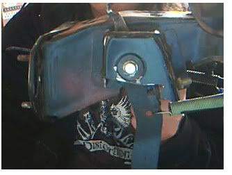

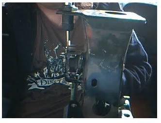

Postby 79rolla » Thu Jul 23, 2009 11:47 am
here is what i did for future reference
should be the same for ke30 ke36 and maby even ke70?
http://i102.photobucket.com/albums/m109 ... lebox7.jpg
http://i102.photobucket.com/albums/m109 ... lebox8.jpg
sorry bout picture quality. had to take them with web cam as i don't have access to our camera atm
