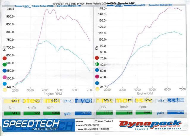

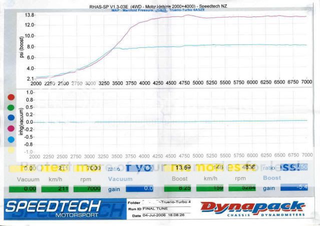

This is my old 8:1 4agze, Link G1, T28, standard injectors and pressure.
The limiting factor was the injectors.
13.7psi
