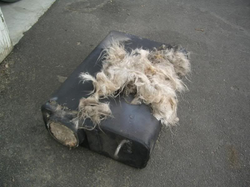

Postby Bazda » Mon Aug 10, 2009 8:44 am
Id say blocked muffler.
I've had this happen to me twice before. And seen it on 2 other cars.
I did a conversion to a 4agte, car would boost the same, sound the same, a/f was all good, timing was good, had me stummped for a week!.
Took the exhaust system off and it was alive again. So started cutting up the ex system and found the resonator to be blocked.
My old car, it started to slowly get slower, same symptons as above, the flexi in the ex system had collapsed.
Dad had a VR4 in the garage, coulndt figure why it got slower from the time they put in cams till 1 week after. Blocked flexi.
Out at Manfield, a customers escort just wouldnt pull, we even took the carbs off to clean them out, found to be a blocked muffler.
