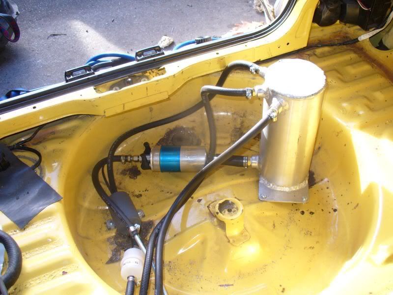

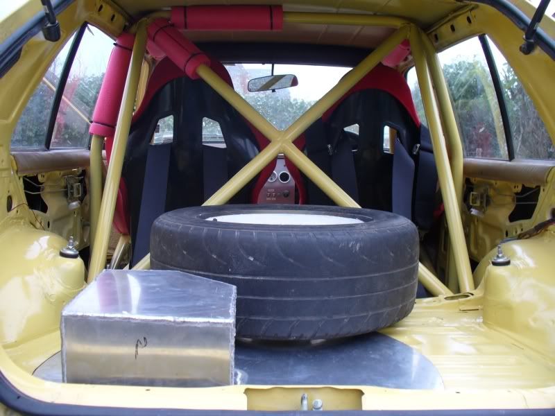

Postby Burning Angel » Mon Aug 10, 2009 4:49 pm
you need to have all the fittings isolated from the cabin, but you dont need braided lines. i put my set up in the spare wheel well and made a cover for it.
