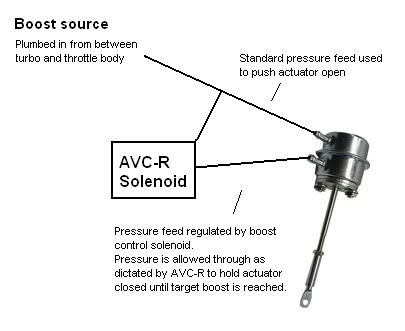

Postby Lith » Fri Aug 14, 2009 3:48 pm
^^ Now look what you've made me do, I've had to go and play with Paint!
Hopefully this explains what and how I've been trying to achieve things:

Postby gasman » Fri Aug 14, 2009 5:20 pm
going from your diagram, you would want the avcr to be pulsing quite quickly to keep the valve closed then open up after boost case come on then slowly close up again as it gets up to the top of the rev range to compensate for the turbo starting to boost outside its preferred limits. And going from what has been said previously about the avcr you can only set the target boost level and not the duty cycle of the solenoid directly.
Thus u need some kind of way to set the avcr to pulse quckly from once it hits boost until it boosts upto 15psi then pulse slower to open up the wastegate.
Or find another hack to make it work

Postby fivebob » Fri Aug 14, 2009 5:30 pm
How about plumbing it so that both sides are connected to the boost signal, and the AVC-R solenoid bleeds boost off the lower side when it reaches target boost, i.e. it vents to atmosphere.
That should make the wastegate open slower, though it's also possible that, depending on the size of the hoses, the wastegate may not open at all if the pressures equalise. In which case I'd try a smaller hose going to the lower side.
Postby Lith » Fri Aug 14, 2009 6:01 pm
fivebob wrote:How about plumbing it so that both sides are connected to the boost signal, and the AVC-R solenoid bleeds boost off the lower side when it reaches target boost, i.e. it vents to atmosphere.
Thats how its plumbed.... unless I have read you wrong?
2007 Mazdaspeed Axela
Lith
Posts: 3137
Location: Kapiti
Postby fivebob » Fri Aug 14, 2009 6:38 pm
Like this?
Users browsing this forum: Google [Bot] and 11 guests
