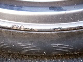

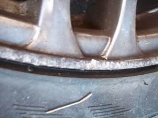

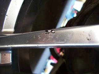

Postby 0EBUNY » Wed Sep 09, 2009 3:58 pm
ok this is the mags at a distance. this is the best one i think there's pretty much no damage (there's not as many spokes as there could be lol)
the passengers side front is really bad most of the pics are of that one.
the others have a rim on the edge this one has no rim left its been ground away.
the other 3 wheels are more like this just the odd stone chip here and there. the two from the drivers side barely have any chips at all.
hope that helps. wat do ya recon it would cost? as i said there's the main damaged one that's pretty bad the second ones not too bad and the other two are petty good *sorry about all the break dust probably doesn't help*

Postby tsoob » Wed Sep 09, 2009 4:16 pm
hmm its pretty bad ay, that wheel would be around the $200 mark (give or take a little) to have it fully restored, does kinda leave the question is it worth it ?

Postby Bling » Wed Sep 09, 2009 4:58 pm
Make sure you put the reg on hold :wink:
[backyard customz] tidy up the sharp bits on the spokes, and bog the gouges, then take a wheel into a auto paint shop and ask for a colour matches spray can. Mask the 'repaired' area and give them a spray, spraying a small amount on the unrepaired part in an effort to blend the paint. Probably no point fixing the edge of the rim as next time you get a tyre taken off it might all come undone, so just give that a sand/ light file and give that a spray too. [/backyard customz]
That will give you an 'ok' result, which will look better than it does now, but not like new or anything. Its a $30 repair compared to a possible $400+ repair. Hit one of the toyspeed tyre gurus up for a price for some new rims maybe, then flog yours off on trademe to subsidise the new wheels cost.
