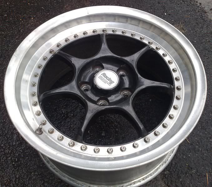

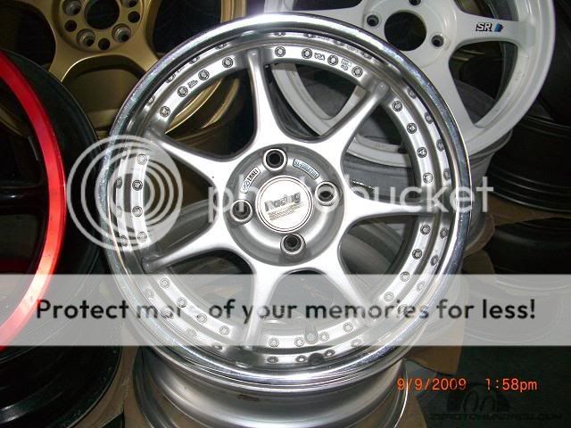

Had a quick search but don't think this has been covered before. Wanting to get my wheels painted gloss black in the middle to go from this
to this
Im wondering which option will give me the best, most durable finish painting them or powdercoating them? And which one will be most cost effective.
