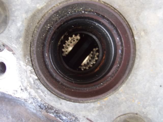

Postby Anth_555 » Tue Nov 17, 2009 7:41 pm
this gearbox is from a curren 3sge
what i want to no dose the bar mean its lsd or non?
and if is lsd i have been told that in the currens the ones with lsd is also the same gearbox as in ss3 celica with the shorter ratio ?

Postby gasman » Tue Nov 17, 2009 8:14 pm
doesnt having the bar going across mean its likely that its an open diff since the bar is needed to join the two spider gears together? altough in saying that the 4agze's seem to be backwards in that having the bar means its lsd and no bar means it isnt lsd.
then if you go to the c52's which are definately not lsd they do have the bar.

Postby Anth_555 » Tue Nov 17, 2009 8:19 pm
yea well thats why i ask i got told that if a ze gearbox has a bar its lsd but then got told the bar means non lsd .

Postby Truenotch » Tue Nov 17, 2009 10:15 pm
Most LSD's I've seen have no "bar" in the middle... but the easiest way to check is to shove in an axle and see if they both spin the same way.

Postby KinLoud » Tue Nov 17, 2009 11:15 pm
Open = bar across
I think the lsd equiped curren/celicas (fwd) have a viscous lsd. Viscous lsd gearboxes have an extra set of splines on one side

Postby ®usty » Wed Nov 18, 2009 6:19 pm
yea not a LSD type, so maybe a S54-02A/-06A?
the shorter gear ratio gearbox, your thinking of is the E56?
Easy to identify as it has an external gearbox cooler) and where only on the superstrut SS-II in the early years. As far as I know.
BEAMS SS-III still had the S54-06D (same with previous years) but had a helical lsd, instead of the viscous LSD.
