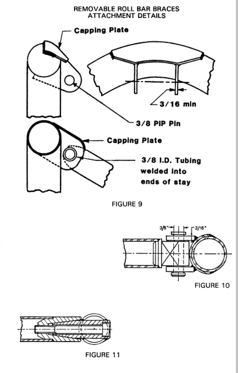

Hi there, Im doing the roll cage in my V8 Celica, but i need some of the cage removable.
I have seen a few drawings on how to do this, but havnt seen one in person... i dont want to get it wrong and have to redo it.
This is what i know...
Removable roll cage bracing is acceptable in one of the
following configurations:
a. If one tube fits inside another tube to facilitate removal,
the removable portion must fit tightly and must bottom by
design, and at least two bolts must be used to secure each
joint. The telescoping section must be at least 8 inches
long. The minimum bolt diameter is 3/8 inch.
But does anyone have achual pictures of this? or better drawings?
http://drifting.com/FD_Rules_3.gif
Thanks, Rob

Postby jakesae101 » Sat Dec 12, 2009 5:21 pm
ring msnz and talk to there tecnical departmentand they may be able to provide you with drawings or possibly leon will chime in here and be able to tell you

Postby Leon » Sat Dec 12, 2009 5:23 pm
http://www.motorsport.org.nz/Pdf/LiveMM ... 0SchA7.pdf
http://www.motorsport.org.nz/Pdf/LiveMM ... ch%20A.pdf 4.4
Ask Motorsport NZ too. Talk to your cage constructor. Lots of people fck up removable members so please double and triple check before you cut or weld anything :wink:
Postby CelicaGT8 » Sat Dec 12, 2009 6:16 pm
cage constructor... that would be me :D
Yea i have Sked A and i think i know what to do, but some real life pics would just be great!
Trying to get a good hunk of the cage done this weekend, so theres not realy anyone i can ring...
Thanks anyway guys,
