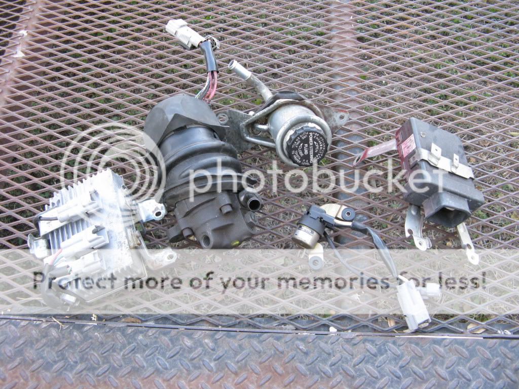

As some of you might know i own a series 4 rx7, the power steering unit in it was a big fat bitch so i ripped it out (and it looked dam untidy) now iv been trying to find a smaller unit to replace it with then i got told that mr2's have electric powersteering pumps
Is this true? can i run that pump on my rx7 rack? any other stuff i should know? i love the idea of a non mechanical pump so a electric one would be awsome, has anyone got 1 or any pictures or dimentions ?

Whole unit weighs around 13kg I believe
But check out this link for a custom mr2 ps fit
http://www.cameronsoftware.com/ev/EV_Po ... stall.html

i have tried running an MR2 electric PS pump in a S4, didn't work. the issue the S4 has it it has 2 high pressure feeds to the rack, not 1, we tried feeding both of them the same pressure and it was like no power steering at all. GOOD LUCK on getting it going.........
