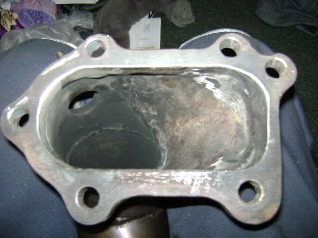

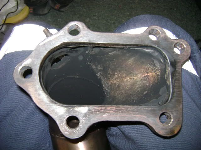

At the moment i have a 3" aussie exhaust downpipe, a while back it got wet while hot and cracked it, got it welded up and its been fine, but now it feels like the metal has gone brittle.
Took it off while removing turbo and noticed its cracked again ( not on original welds but near it.
Now another aussie exhaust one is way out of budget at the moment, so was looking for something cheaper.
http://www.drivenperformance.co.nz/scripts/prodView.asp?idproduct=478 like this one.
Now I keep hearing stories of cheap trademe ones fouling the actuator, has that been known to happen with these ones too? or will this do fine?
Or will patching up the current one do until funds permit buying another aussie one.
2011 Ford Mondeo tdci.

Postby MR2BOY23 » Sun Jan 17, 2010 6:42 pm
Aussie downpipes are supposedly the best, but I've heard of a few of them cracking.
had my el cheapo one on for about 5 months with no issues so far, Just welded up a support bracket for it too take some of the stress off it
Heylin used his for a year and half I believe before it cracked..
You can see where the gasket had been sitting, all that area had to be
ground off so after that you shouldn't have any problems with the wastegate sticking

Postby MR2SIK » Sun Jan 17, 2010 7:03 pm
is it just the flange being the wrong shape? pretty piss poor that a shops selling these to fit a specific turbo and it doesnt even line up :?

Postby MAGN1T » Mon Jan 18, 2010 9:30 pm
Just have to put a few gussets in the right place and it should be strong enough. Easier to mod than to replace.
