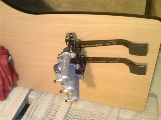

Postby evil_si » Thu Jan 21, 2010 4:27 pm
some american tanks had electric brake boosters,
for my ute ive got a wilwood pedal box that i will be running with twin 1" master cylinders, and with that setup i dont need to run a brake booster.

Postby stalker » Thu Jan 21, 2010 4:35 pm
evil_si wrote:...
Damn thats nice!!!!!!!!!
*now for the blond question* Wouldnt that mean that I wouldnt get the vac assist braking using something like that setup??

Postby 79rolla » Fri Jan 22, 2010 10:27 am
that's priiy big, iv seen bigger tho lol... looks verry shiney tho...
and the break booster is a vacume assist
on evil si's setup because the cylinders are so mutch digger you dont need it, there is alot of theroy involved and even more maths... ill let some one els elaborate lol

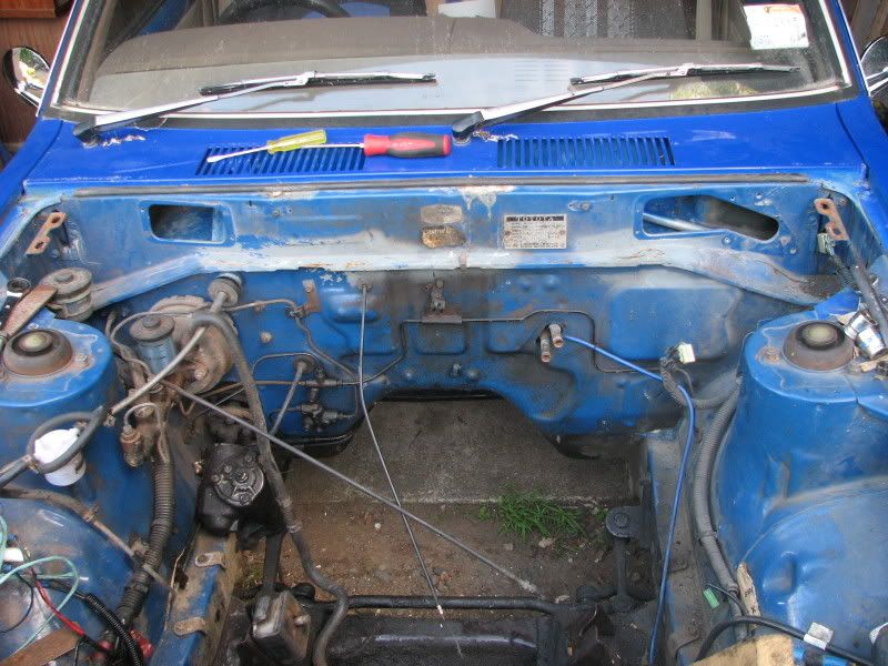

heres a pick of my ke30 engin bay
http://i102.photobucket.com/albums/m109 ... 1264109098

Postby stalker » Fri Jan 22, 2010 11:18 am
ahhh yea, yours looks a LOT smaller. I must have gotten the mutant version
