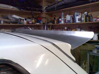

Postby fxgt race » Mon Feb 08, 2010 5:54 pm
The rear of my car was a hand full so i made this little spoiler on the back, made all the difference on cornering speed. And the front splitter i made from 4 mm ply, need to do research on splitters as its about shape to cause low and high pressure zones to suck the front off the car down . You don't want to go to big on the back as it will slow you down on the straights, speaking from experence as i had a bigger one on the back and lost 300rpm down the back straight of puke.

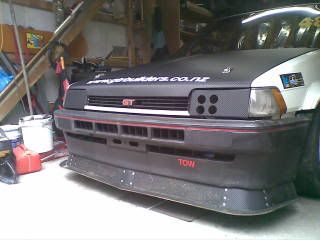

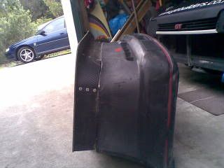

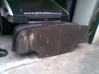

Postby molex » Mon Feb 08, 2010 9:51 pm
jeez, you lot are all a bit negative aren't you...
I did quite a bit of reading into amateur aerodynamic mods and more importantly, testing to ensure it's actually of benefit.
there's a lot of info out there but you have to think a bit outside of the box. One of the best sources I found of empirically tested aerodynamic mods with proven results was the eco nuts that modify their cars for upteen bizzilion miles to the gallon. Most (but not quite all) of their mods for efficiency translate very well into mods for performance, be it in a straight line or cornering. They have some pretty innovative ideas on how to do it on the cheap too.
I haven't quite got their myself yet, but it's definitely on the cards to make up an undertray/front diffuser/airdam to suit my EP82, I'd be keen to trade ideas/build something together if you're interested.
I even went so far as to take some measurements and do some drawings in sketchup of a two piece undertray with mounts that you could remove in a couple minutes. Damned if I know where the damn file is now though.
