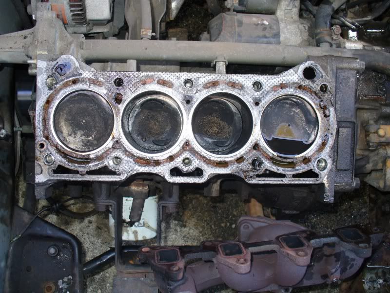

Postby Burning Angel » Sat Feb 27, 2010 11:52 am
well had a look at the beast 2day and it seems like it is a BHG, bubbles coming out radiator when warm, still blows out about 2L of coolant even with a new Rad cap.
Also starts like a sack now, probly due to drawing water into the cyl when its off.

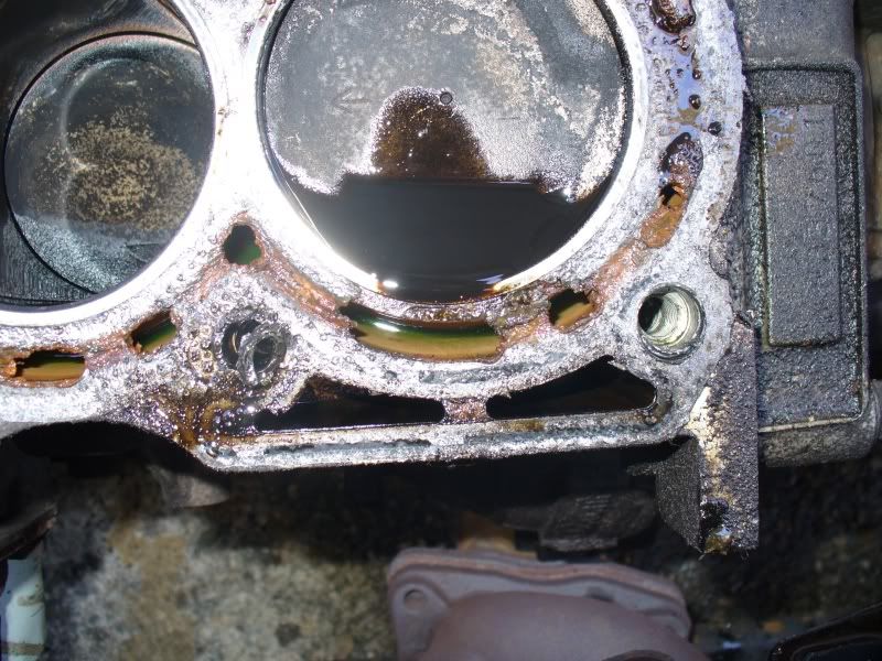

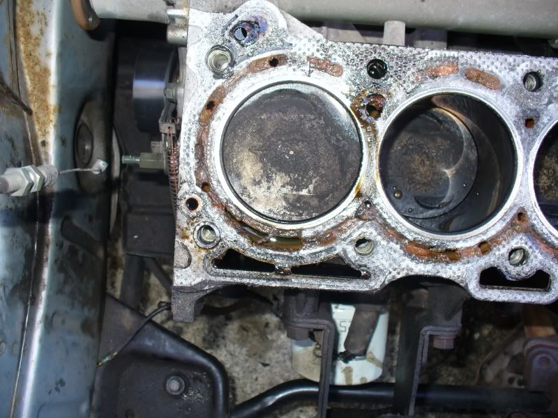

Postby Burning Angel » Sat Feb 27, 2010 2:17 pm
Yup definitely a BHG
Blown in two places, exhaust side of #1 & #4

Postby Burning Angel » Sat Feb 27, 2010 6:17 pm
cat007 wrote:good effort!
Hopefully she'll be back on the road in no time :)
just finished putting it together, goes mint now
also the timing belt was out 1 tooth which explains why it used to be so guttless.
